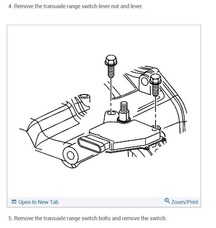

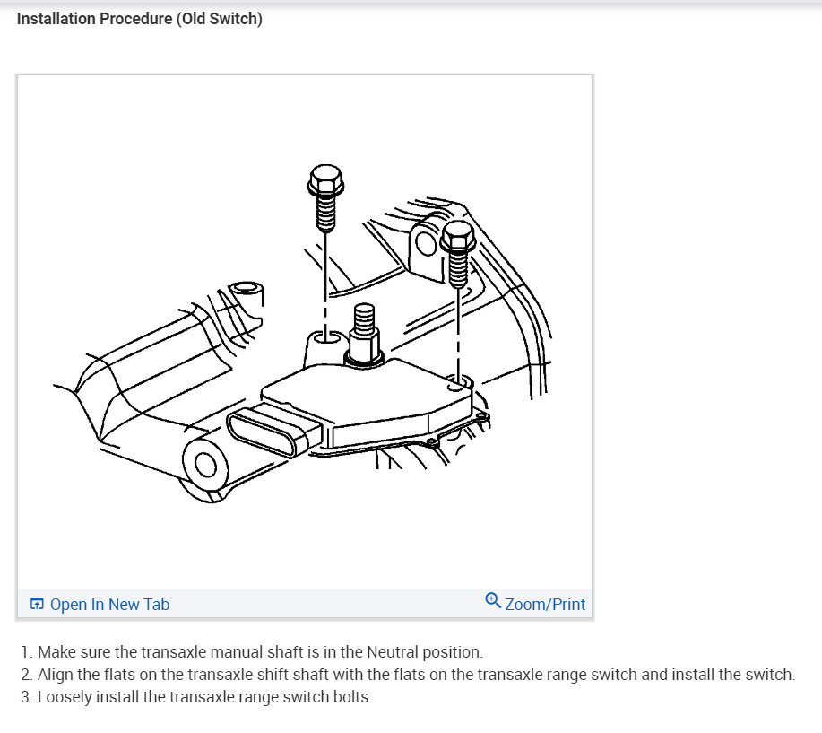

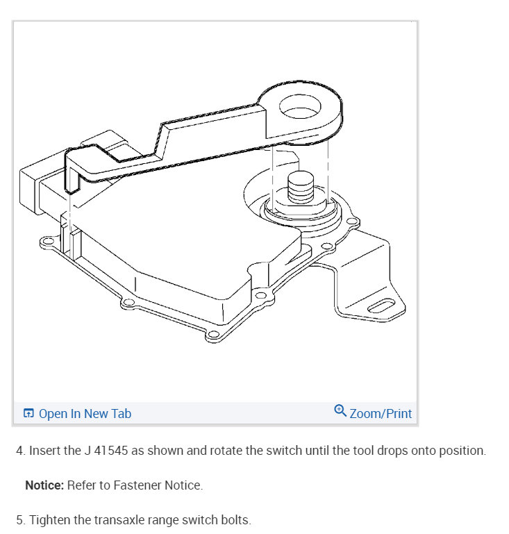

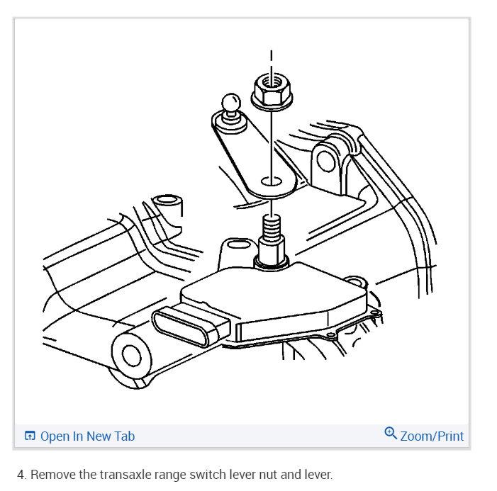

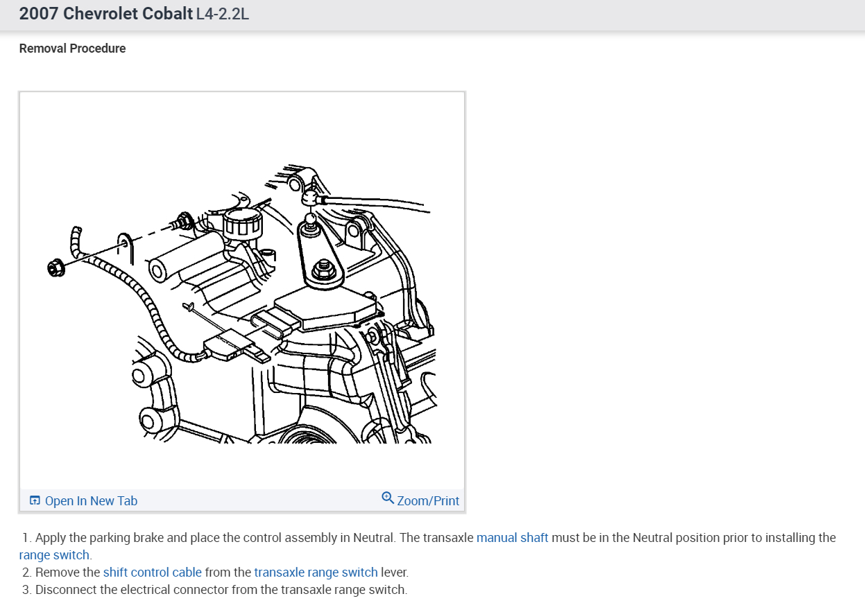

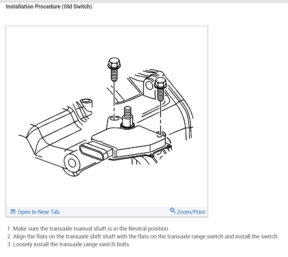

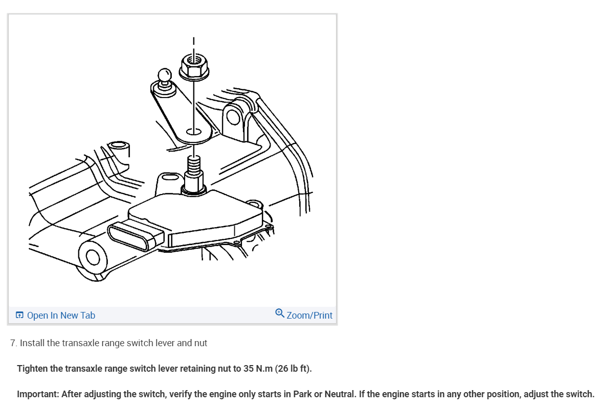

Hi, my car recently started idling at 1100 rpms so i cleaned the throttle body and made sure not to touch the electrical sensors. Now my car fluctuates between 1000-2000 rmp in neutral. When I'm on the highway the rpms jump up to 3000 rpm when I'm hitting the clutch. I was told it could be the neutral safety switch. Where is that located?
Mar 13, 2016 at 3:38 PM
HMAC300
  • 48,601 POSTS
check for a vacuum leak first and make sure you cleaned both sides of throttle plate and iac hole. Neutral switch is on transmission near the shift cable. Check out the diagrams (Below). Please let us know what happens.

wre is it located on a the car?

park neutral position (PNP) switch is located on the left side of the engine compartment, on top of the transmission.
