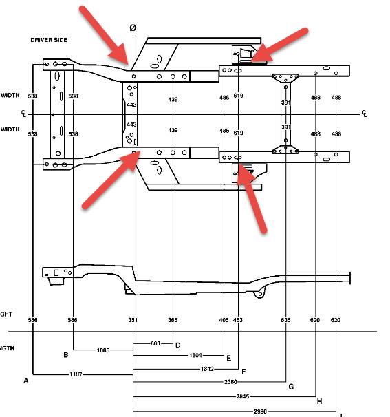

Will replace rear brakes. I need to know exactly where to safely place jack stands due to limited "jack" placement on frame for this unibody car.

there are under the car where there are two pieces of metal coming together under rocker panels. place there close to whatever end of car you are working on. Not on rocker panel but on the what is called the pinch area. you should see it once car is up
