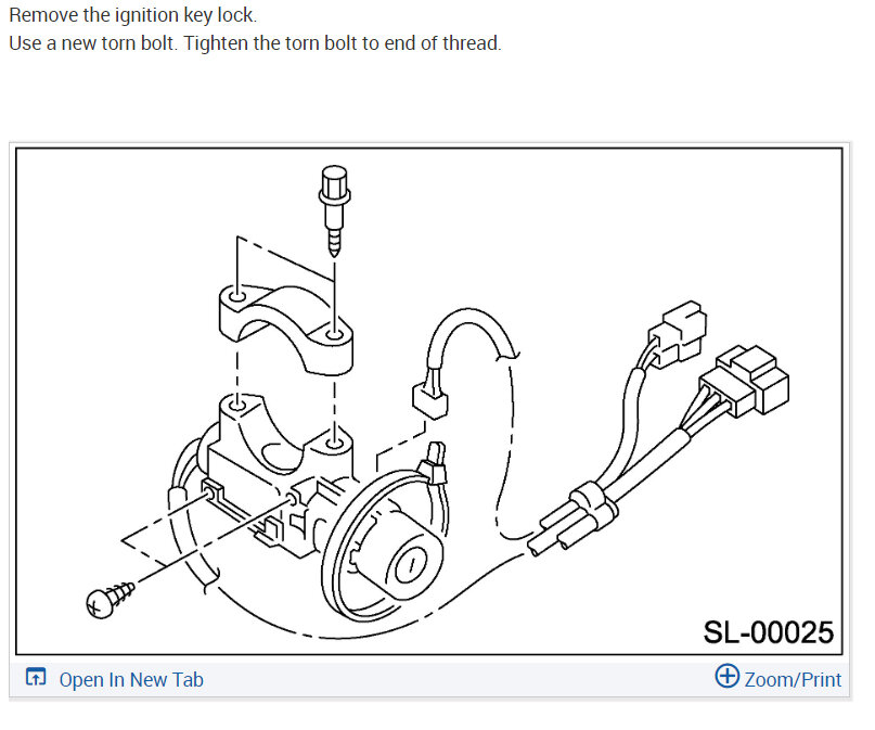

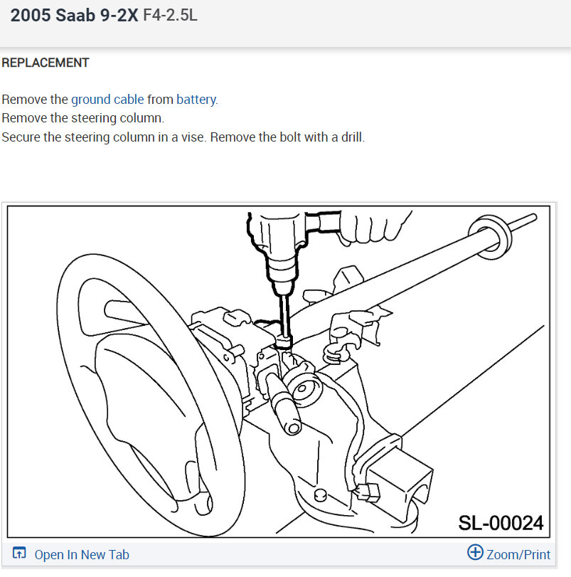

Here is how to change the ignition switch out. Check out the images (below). Please let us know what happens.
