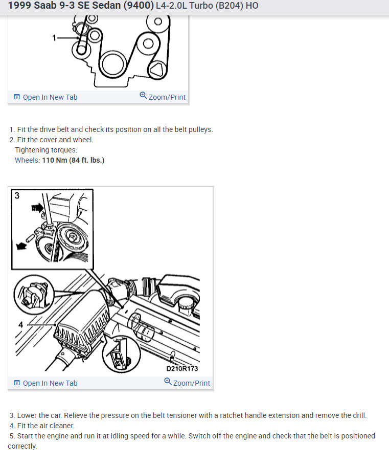

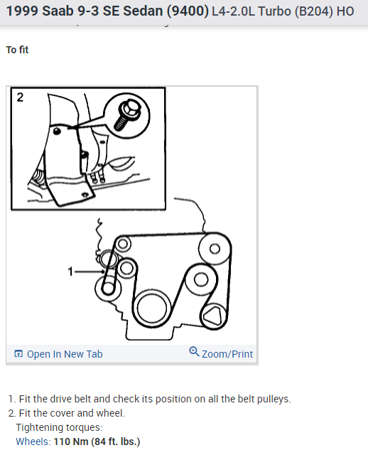

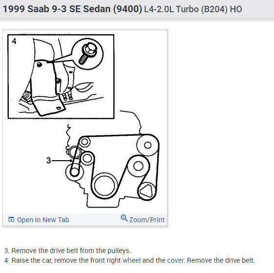

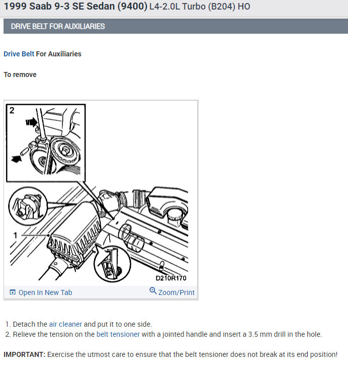

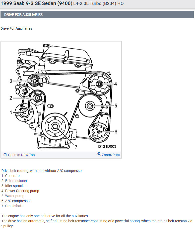

I have included the belt replacement procedure for your reference.
