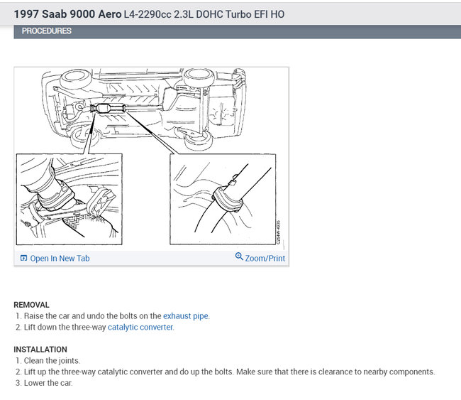

It sounds like to me that you have a clogged exhaust system, either the cat has broken apart and clogged or the particles from the cat has clogged the muffler. The way to confirm this failure is to raise the car up and then take a rubber mallet and softly stick the catalytic converter and muffler to see if you can hear anything rattling around inside the two. This will let you know if the cat is bad, Also this guide can help, it will tell you to disconnect the exhaust in front of the cat to see if the engine will rev.
The diagrams below we show you where to undo the exhaust system. Check out the diagrams (Below). Please let us know what you find. We are interested to see what it is.

disconnect and check the way the engine runs to see if I am correct please?
Apr 28, 2010 at 5:53 AM
CMEENS
Thanks again for the quick reply. So I tried what you said and I started it with no problems and drove it around about a mile without issue, thanks for your insight. This site is great btw. I should have done this earlier
