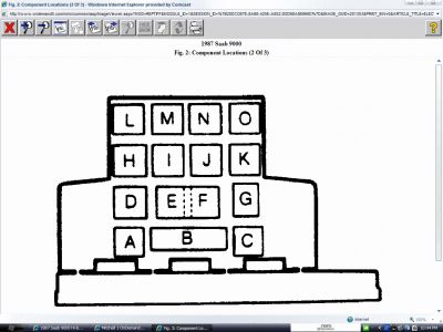

Went online, asked about cause, was told it was probably the hi-beam relay.Bought a relay online. Problem: We can't find the relay!Need to know where the hi-beam relay is. Thanks! Mark Elam

Possition K in relay panel, behind fuse box, in glove compartment...Check out the diagrams (Below). Please let us know if you need anything else to get the problem fixed.
