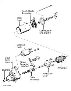

I Have a 1996 Saab 900s 5 speed manual
selonoid may have died
can you please tell me when you crank the saab to start and turn over it makes a whizzing zipping noise is that the starter motor gone or selonoid or both or is it something else
Thanks

replce the starter motor and check the flywheel teeth when starter is removed from vehicle !
https://images.2carpros.com/forum/automotive_pictures/266999_saab_6.jpg
