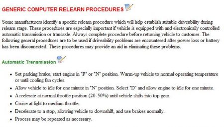

I have a saab that has not passed smog. When i got the car it had been parked with a bad battery. The smog person told me that the computer had to clear checks and I had to drive the car for awhile. I have put 250 miles and it failed for the same reson DO I ned to drive in winter and sport for ot to pass pr how many miles?

Hi there, Thank you for the donation. This is the re learn for the Saab 900S auto i would get a scan done and check for any set fault codes, clear codes and do the re learn , re scan and if codes are re set post codes for further information. mark (mhpautos)
https://images.2carpros.com/forum/automotive_pictures/61395_Noname_40.jpg
