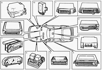

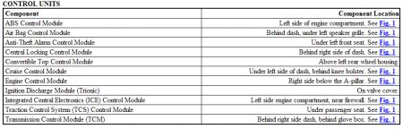

hi- I recently bought a replacement ICE module and I have been searching all over for some help as to where this module is located. any help would be greatly appreciated

Left side of the engine compartment near firewall. #5 In the diagram.
