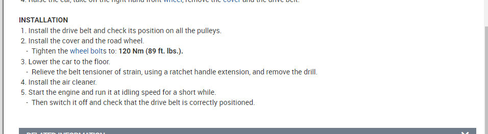

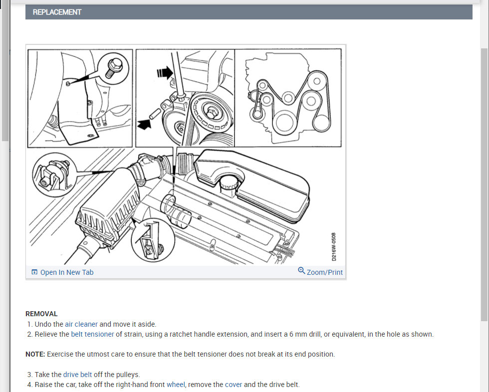

How to install a drive belt on a 1995 Saab 900 SE?
Sunday, March 15th, 2009 AT 7:39 AM
MECHANIC
18,907 POSTS
Here is a guide that will help with replacing this belt:
Please run through this info and then review the info below from the manual that will help with routing the replacement belt.
Please see below. Let us know if you have other questions. Thanks
