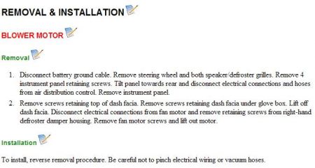

I'm looking for details on removing and replacing the blower fan on my '85 Saab 900 Turbo Sedan, any help or links would be much appreciated. Thanks!

Below are the replacement procedures for your vehicle's blower motor. These steps will gain you access to the blower motor fan so unless the fan is attached directly to the motor then you will not need to complete all of these steps for removing the fan.
https://images.2carpros.com/forum/automotive_pictures/261618_Noname_307.jpg
