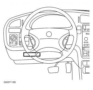

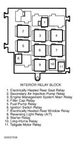

O.K. since car is fickle need you to diagnose. So next time in will not start, will need a test light, find starter relay in interior relay box see diagram
https://images.2carpros.com/forum/automotive_pictures/198357_Grafic_3_127.jpg
Touch relay while starting does relay click? if no pull relay on terminal 30 probe with test light start does light glow?
https://images.2carpros.com/forum/automotive_pictures/198357_Graphic_475.jpg
relay # 9 Let me know
