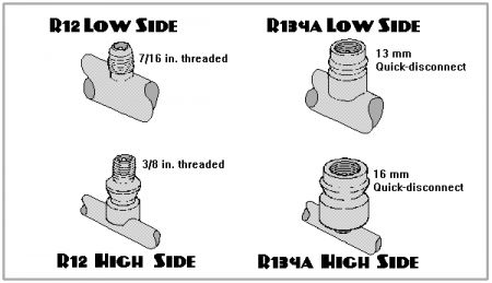

Cannot find low side filler for A/C charge
May 21, 2010 at 3:20 AM
  • 75,992 POSTS
Look for the 13mm fitting within the AC piping should be between the compressor and condenser-
https://images.2carpros.com/forum/automotive_pictures/12900_ac_service_fittings_32.jpg
