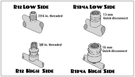

Cannot find low side filler for A/C charge
Friday, May 21st, 2010 AT 10:20 AM
MECHANIC
75,992 POSTS
Look for the 13mm fitting within the AC piping should be between the compressor and condenser-
