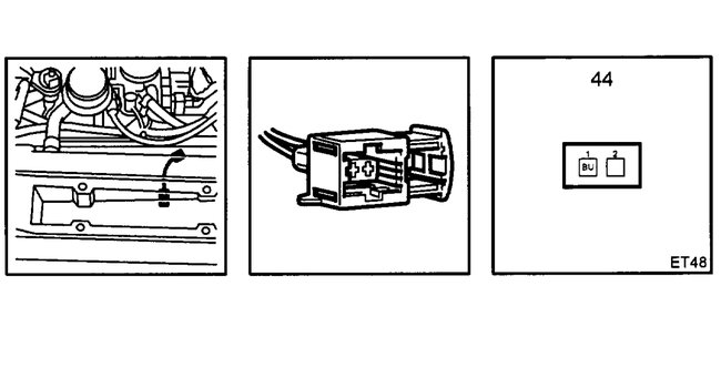

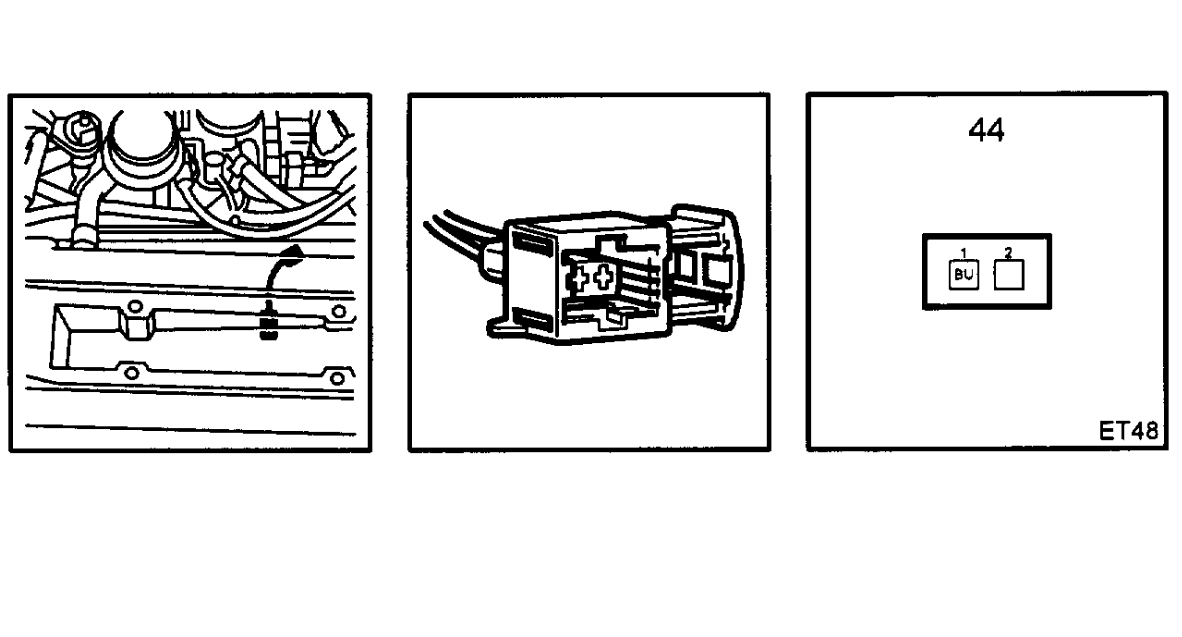

where is the oil sending unit a on this model
Apr 28, 2010 at 6:14 AM
SQM
  • 6,383 POSTS
The oil pressure sending unit is located on the front part of the engine. It is just below the oil filter housing.
This sending unit is a common place for oil leaks on these vehicles.
In order to access that part, you will have to remove the intake tubing.
The sending unit can be removed using a right size socket.
Be sure to replace the washer when replacing the sending unit.
