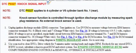

I have already replaced the ignition casset with a brand new unit.
still getting this fault and also random missfires
anything would be helpful

Can be as simple as a bad spark plug...there is no knock sensor on these, and this code really refers to the Ignition module's measurement of plug resistance. Read this...
https://images.2carpros.com/forum/automotive_pictures/62217_P0327a_1.jpg

ignition discharge unit? is that what you replaced?
May 30, 2008 at 5:26 AM
VW GUY
yes the discharge unit
I have pin tested the harness all wire check ok between ecm and coil
