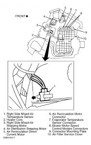

2.Disconnect blower motor 2-pin connector located on passenger-side of A/C-heater assembly. See Fig. Connect a test light between ground and female side of blower motor 2-pin connector terminal No. 1 (Red wire). See WIRING DIAGRAMS. If test light comes on, go to next step. If test light does come on, repair open in Red wire and go to step 8.
3.Connect test light between female side of blower motor 2-pin connector terminal No. 1 (Red wire) and terminal No. 2 (Black wire). If test light comes on, go to next step. If test light does come on, repair suspect circuit and go to step 8.
4.Reconnect blower motor 2-pin connector. Using a fused (30-amp) jumper wire, backprobe blower motor 2-pin connector terminal No. 2 (Black wire) and connect to blower motor terminal No. 1 (Red/Brown wire). If blower motor operates at full speed, go to next step. If blower motor does not operate, replace blower motor. See BLOWER MOTOR ASSEMBLY under REMOVAL & INSTALLATION. When repair is completed, go to step 8.

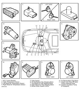

5.Turn ignition off. Disconnect blower motor speed control module 4-pin connector. See Fig.
Connect a test light between ground and speed control 4-pin connector terminal No. 3 (Orange/White wire). Turn ignition on. If test light comes on, go to next step. If test light does not come on, repair open in Orange/White wire between connector terminal No. 3 and ACC control module connector, and go to step 8.
6.Turn ignition off. Using a fused jumper wire, backprobe between ACC control module 39-pin connector terminal No. 1 (Black wire) and terminal No. 35 (White/Green wire). See Fig. Connect a test light between blower motor speed control module 4-pin connector terminal No. 2 (Green/White wire) and terminal No. 3 (Orange/White wire). Turn ignition on. If test light comes on, go to next step. If test light does not come on, repair open in Green/White wire and go to step 8.

Thank you the pictures that u have are good and I think better then what I have I will provide what I have so u will be the judge of that also if u like u can get me the codes and will try to get the diagnose procedure for said code s
https://images.2carpros.com/forum/automotive_pictures/99387_Graphic1_119.jpg
https://images.2carpros.com/forum/automotive_pictures/99387_Graphic2_63.jpg
