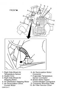

1.Check for continuity between terminals of fuse No. 22 (40-amp), located in main fuse board. Main fuse board is located between instrument panel and driver's door. If fuse is okay, go to next step. If fuse is blown, replace fuse and recheck blower motor operation. If blower motor operates, repair is complete. If blower motor does not operate and fuse blows, repair short in Red wire between fuse No. 22 (40-amp) and blower motor. If blower motor does not operate and fuse is okay, go to step 8.
2.Disconnect blower motor 2-pin connector located on passenger-side of A/C-heater assembly. See Fig. Connect a test light between ground and female side of blower motor 2-pin connector terminal No. 1 (Red wire). See WIRING DIAGRAMS. If test light comes on, go to next step. If test light does come on, repair open in Red wire and go to step 8.
3.Connect test light between female side of blower motor 2-pin connector terminal No. 1 (Red wire) and terminal No. 2 (Black wire). If test light comes on, go to next step. If test light does come on, repair suspect circuit and go to step 8.
4.Reconnect blower motor 2-pin connector. Using a fused (30-amp) jumper wire, backprobe blower motor 2-pin connector terminal No. 2 (Black wire) and connect to blower motor terminal No. 1 (Red/Brown wire). If blower motor operates at full speed, go to next step. If blower motor does not operate, replace blower motor. See BLOWER MOTOR ASSEMBLY under REMOVAL & INSTALLATION. When repair is completed, go to step 8.

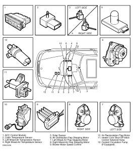

5.Turn ignition off. Disconnect blower motor speed control module 4-pin connector. See Fig.
Connect a test light between ground and speed control 4-pin connector terminal No. 3 (Orange/White wire). Turn ignition on. If test light comes on, go to next step. If test light does not come on, repair open in Orange/White wire between connector terminal No. 3 and ACC control module connector, and go to step 8.
6.Turn ignition off. Using a fused jumper wire, backprobe between ACC control module 39-pin connector terminal No. 1 (Black wire) and terminal No. 35 (White/Green wire). See Fig. Connect a test light between blower motor speed control module 4-pin connector terminal No. 2 (Green/White wire) and terminal No. 3 (Orange/White wire). Turn ignition on. If test light comes on, go to next step. If test light does not come on, repair open in Green/White wire and go to step 8.
7.Turn ignition off. Disconnect ACC control module 39-pin connector. Ensure terminals and wiring are clean, tight and properly connected. See Fig. If connector terminals and wiring are okay, go to DTC B2425. If connector terminals and wiring are not okay, perform repairs as necessary and go to next step.
8.Using scan tool, clear all DTCs from all systems. Recheck A/C system operation for original complaint. If A/C system is operating properly and no DTC has been detected, repair is complete. If A/C system is not operating properly and/or a DTC has been detected, ACC control module may need to be replaced..

Thank you the pictures that u have are good and I think better then what I have I will provide what I have so u will be the judge of that also if u like u can get me the codes and will try to get the diagnose procedure for said code s
https://images.2carpros.com/forum/automotive_pictures/99387_Graphic1_119.jpg
https://images.2carpros.com/forum/automotive_pictures/99387_Graphic2_63.jpg
