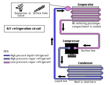

1999 Saab 9-5 4 cyl Two Wheel Drive Automatic

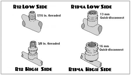

Cannot find a/c lowside for adding refrigerant.
Where is it located.
Sunday, June 6th, 2010 AT 11:32 AM
MECHANIC
75,992 POSTS
You're looking for the 13mm fitting its in piping between the compressor and evaporator-see below
