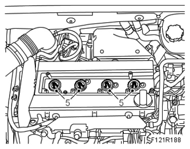

Do you have tips for changing the spark plugs?

Hello .. thanks for the donation .. much appreciated Remove the cover over the ignition coils, undo the ignition coils and move them aside.
https://images.2carpros.com/forum/automotive_pictures/266999_saab2_1.png
Remove the spark plugs.
https://images.2carpros.com/forum/automotive_pictures/266999_saab_1.png
hope this helps
