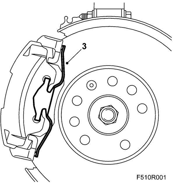

To remove
1. Raise the car.
2. Remove the wheel.
pic 1

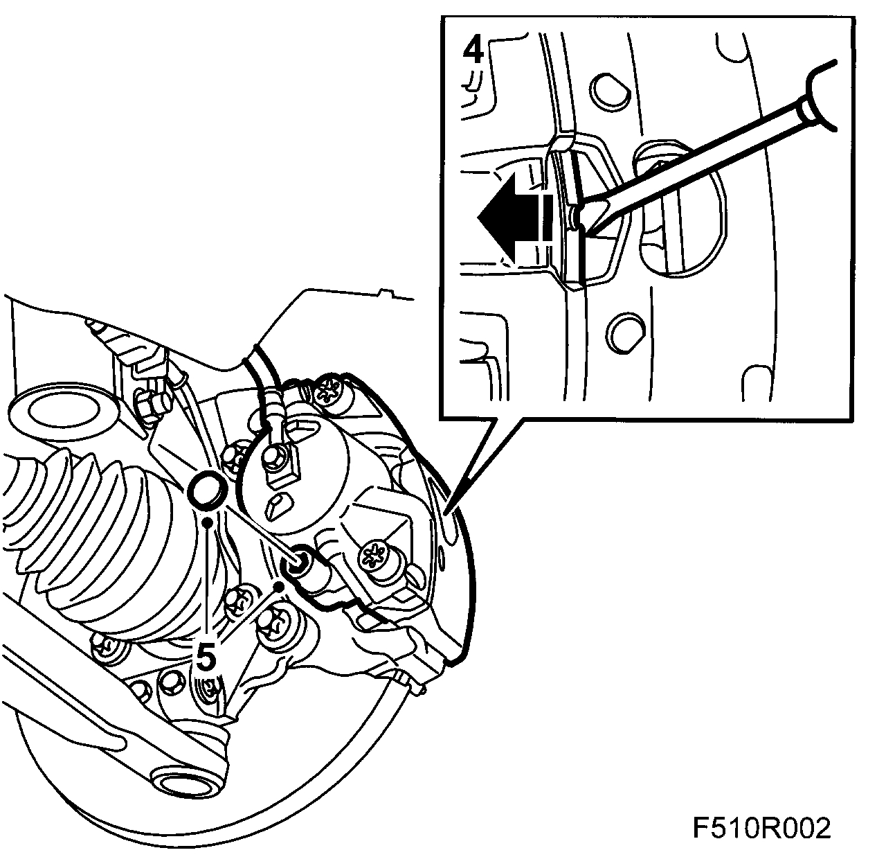

3. Remove the retaining spring from the brake caliper.
pic 2

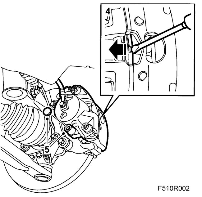

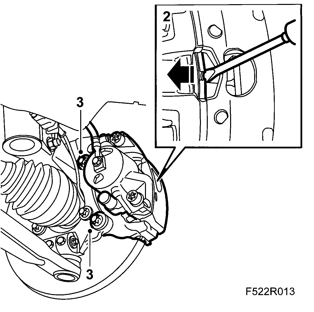

4. Press in the piston by prising with a screwdriver against the brake pad.
5. Remove the protective covers and guide pins.
Lift off the hydraulic body.
Note: Be careful when handling the brake hose.
6. Remove the inner brake pad from the caliper and the outer brake pad from the bracket.
Clean the inside of the brake caliper and check the dust covers.

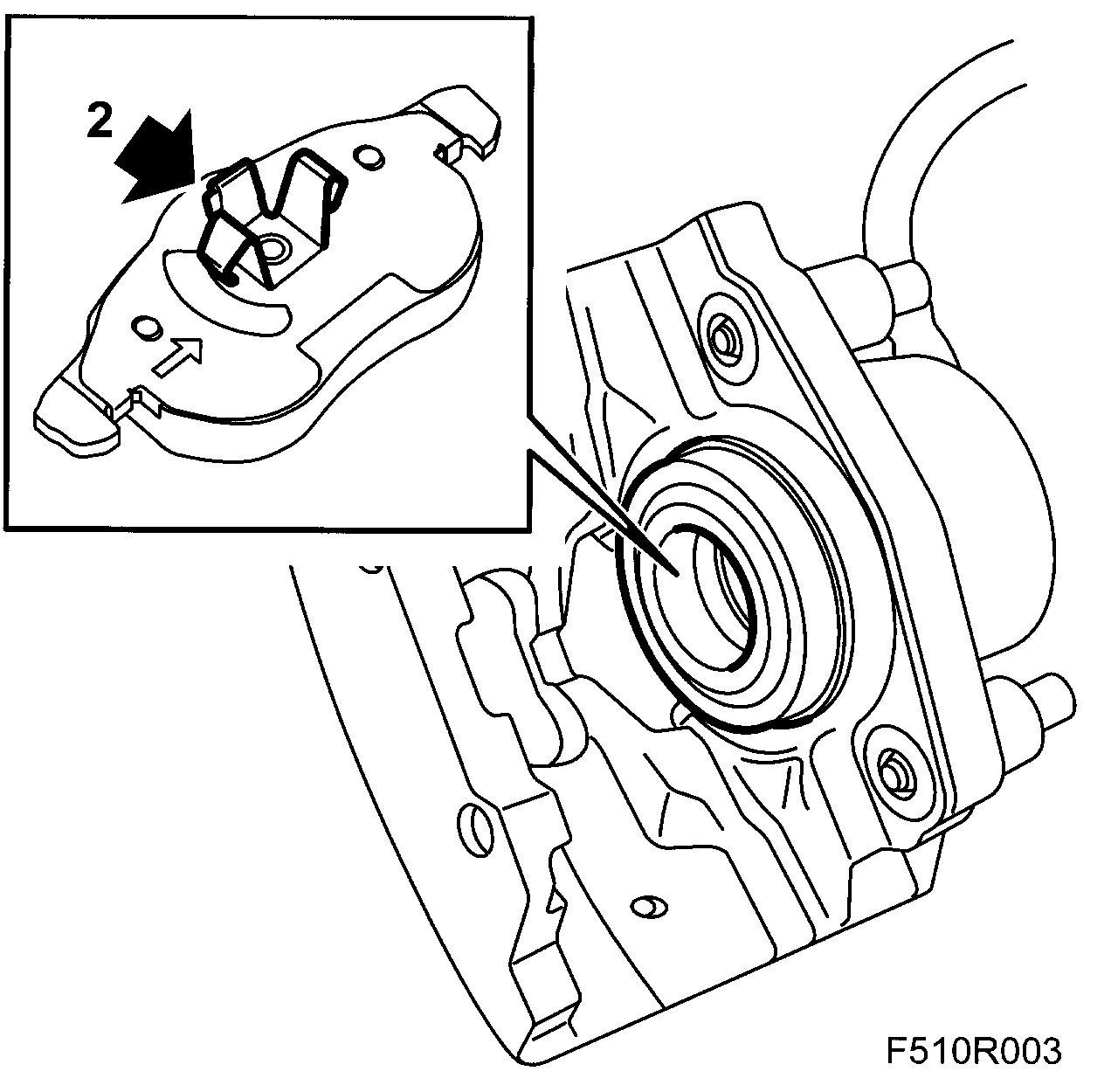

To fit
sa0393sed_fs-005a
1. Lubricate the shoe sliding surfaces with 89 96 993 Special paste.
pic 3
2. Place the outer brake pad into the carrier.
Fit the inner brake pad into the hydraulic body.

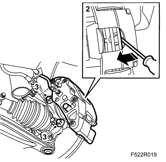

Note: The inner brake pad must be fitted so that the arrow points in the direction of rotation of the brake disc for forward travel.
pic 4

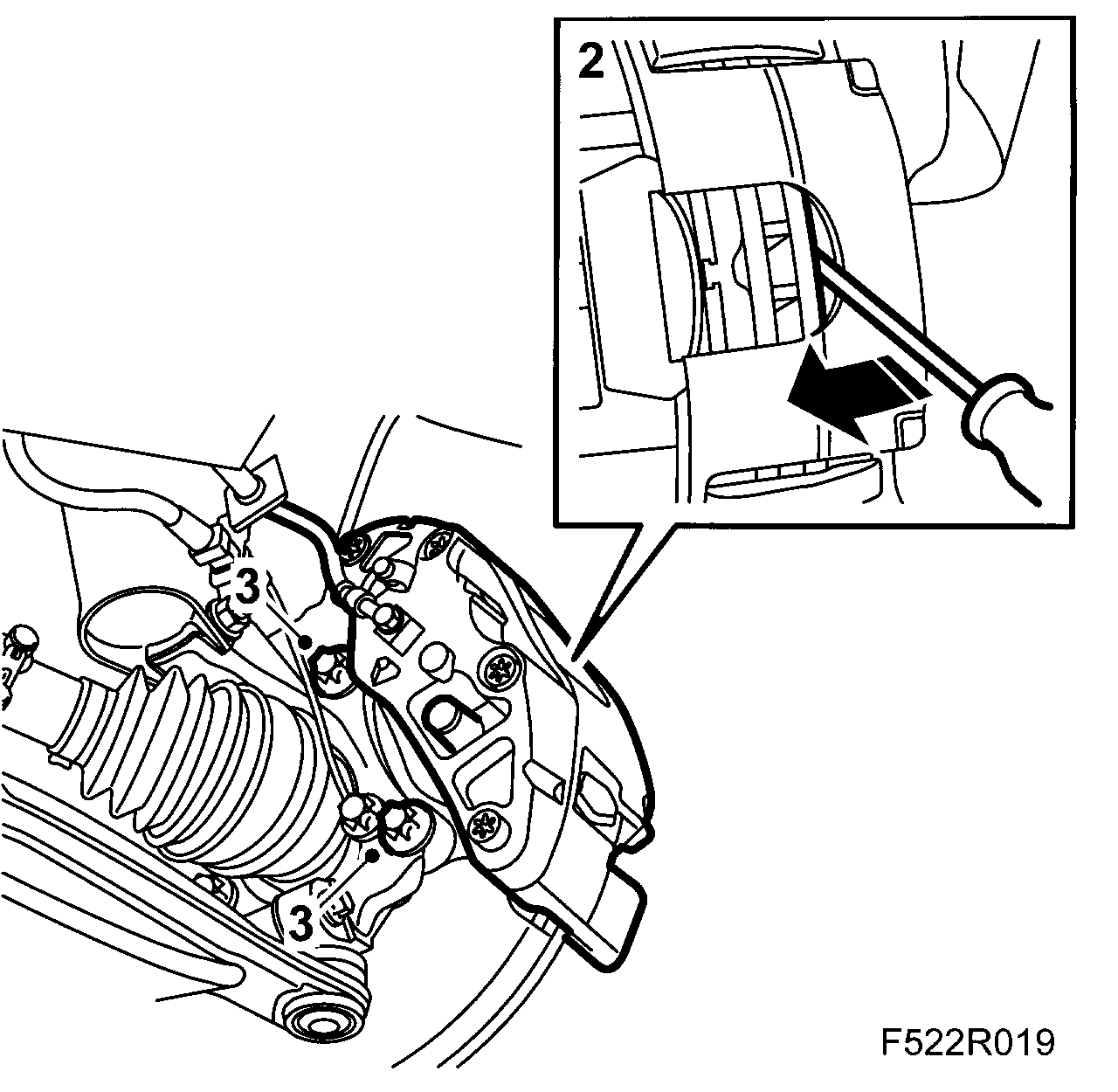

3. Place the hydraulic body into the carrier.
Fit the guide pins.
Tightening torque 28 Nm (21 ft. lbs.)
4. Fit the protective covers.

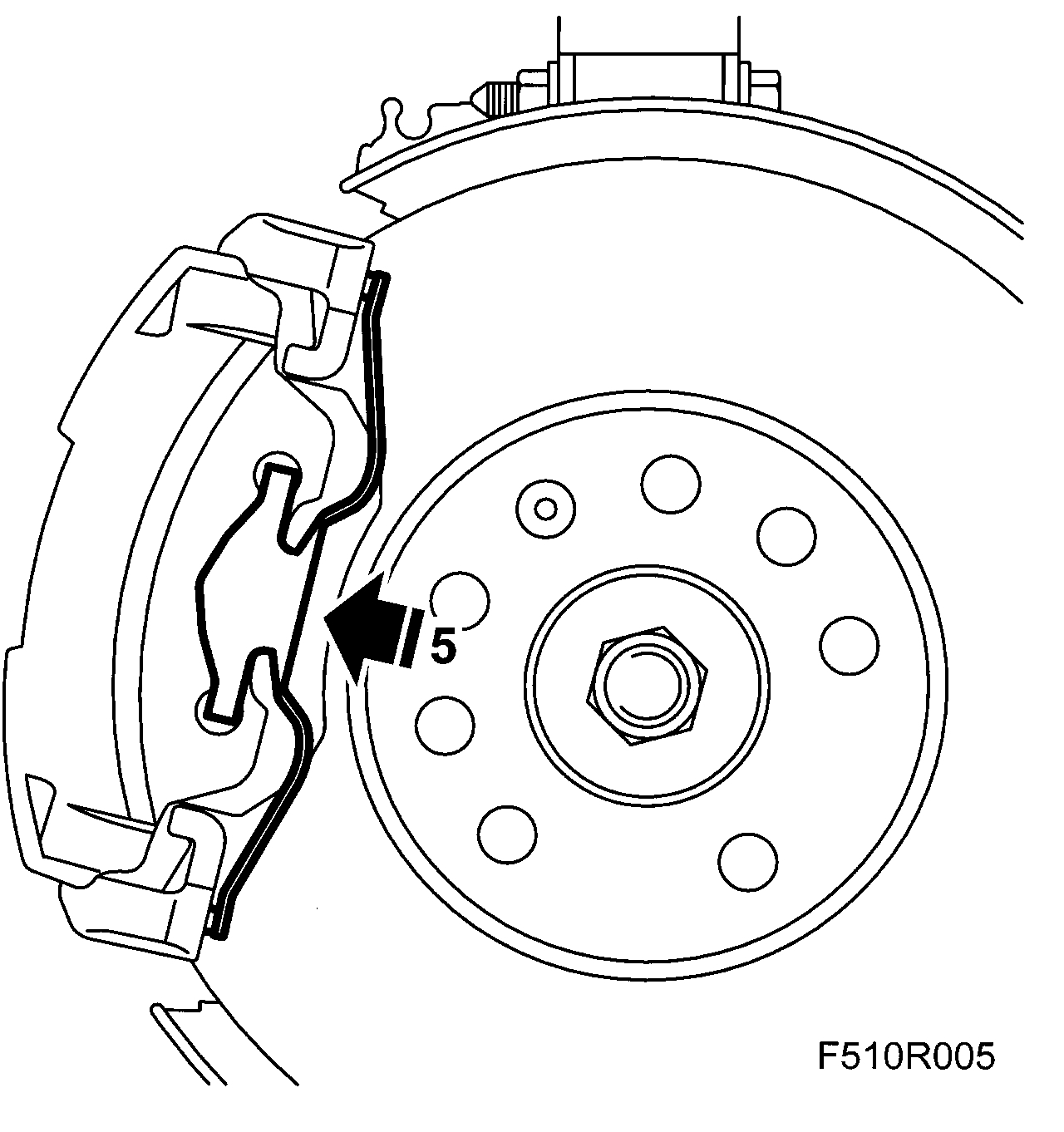

pic 5
5. Fit the retaining spring to the brake caliper. Lay the outer contact surfaces against the bracket and push the centre of the clip.

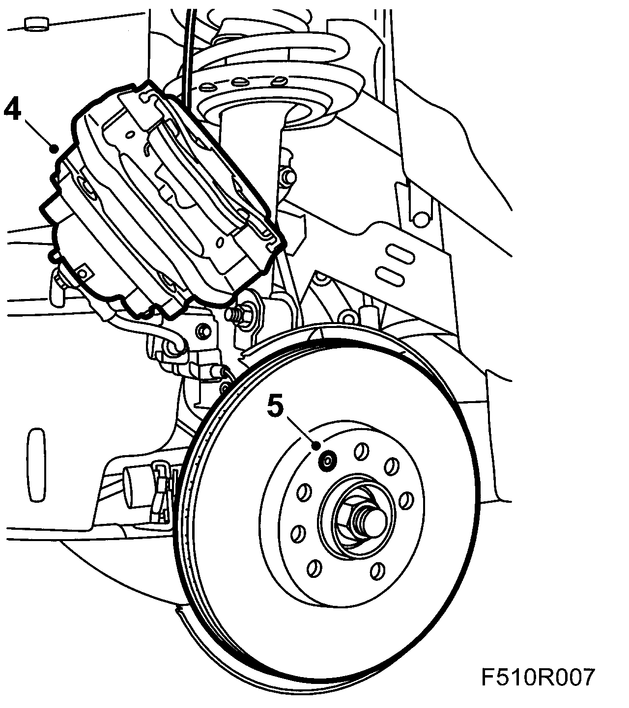

To Remove
1. Raise the car and remove the wheel.
2. Press in the piston.
pic 6
- Level 1 and 2: Press in the brake pad by prising with a screwdriver.
pic 7
- Level 3: Prise between the brake disc and the brake caliper using a screwdriver.

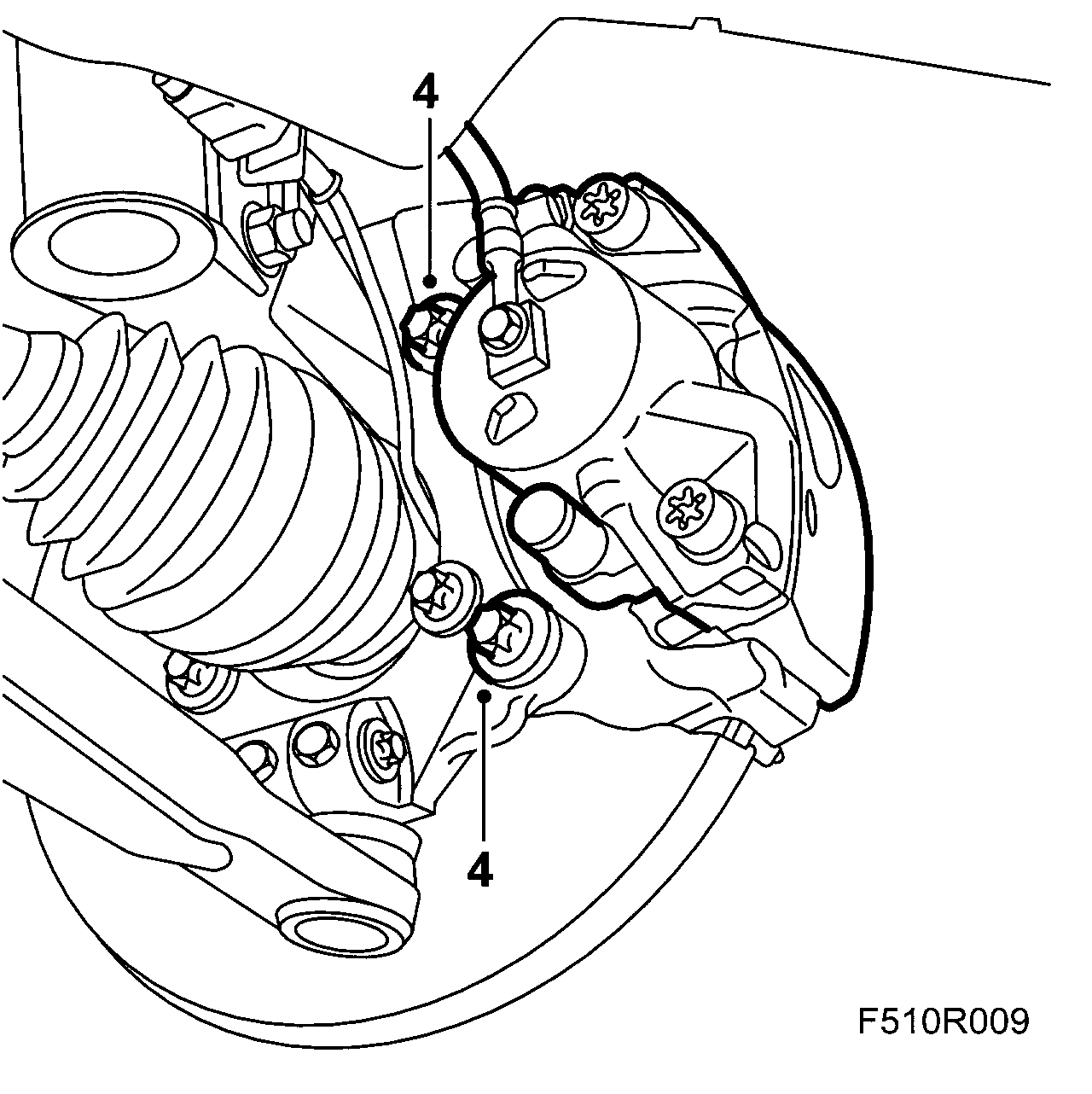

3. Remove the two brake caliper retaining bolts.
Note: Make sure the cable to the wheel sensor is not damaged.
pic 8
4. Suspend the brake caliper from the spring strut.

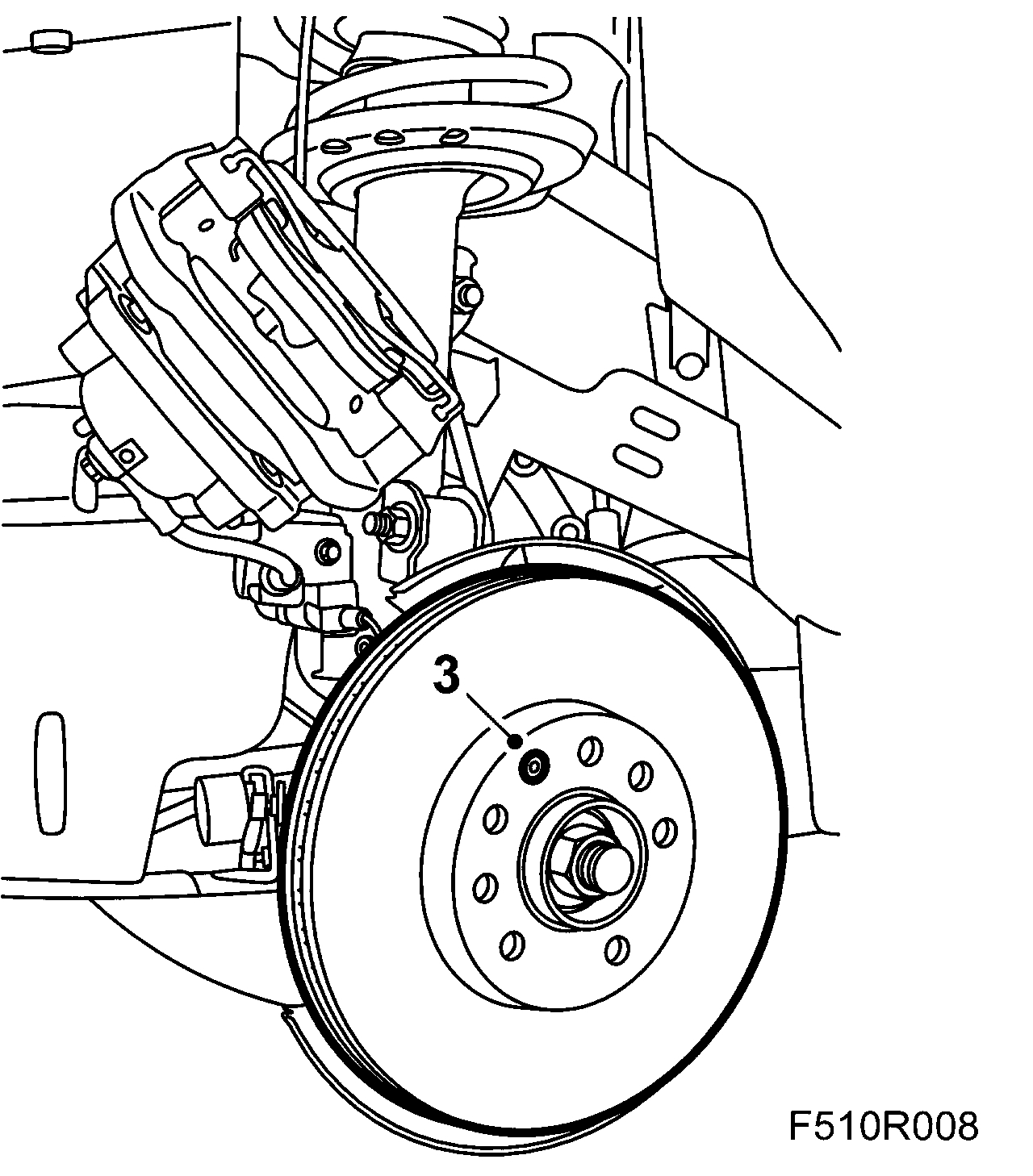

5. Remove the brake disc locking screw.
6. Lift off the brake disc.

3. Place the brake disc on the hub and screw in the brake disc locking screw.
