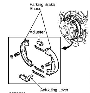

REAR WHEEL LOCKED UP DUE TO SITTING-SEEMS EMERGENCY IS LOCKED ON-HOW BEST TO REPAIR

You need to use a prybar and pull back on the levers. If cables are frozen, once you get the levers back, replace the cables.
