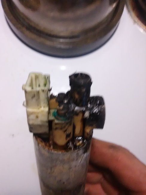

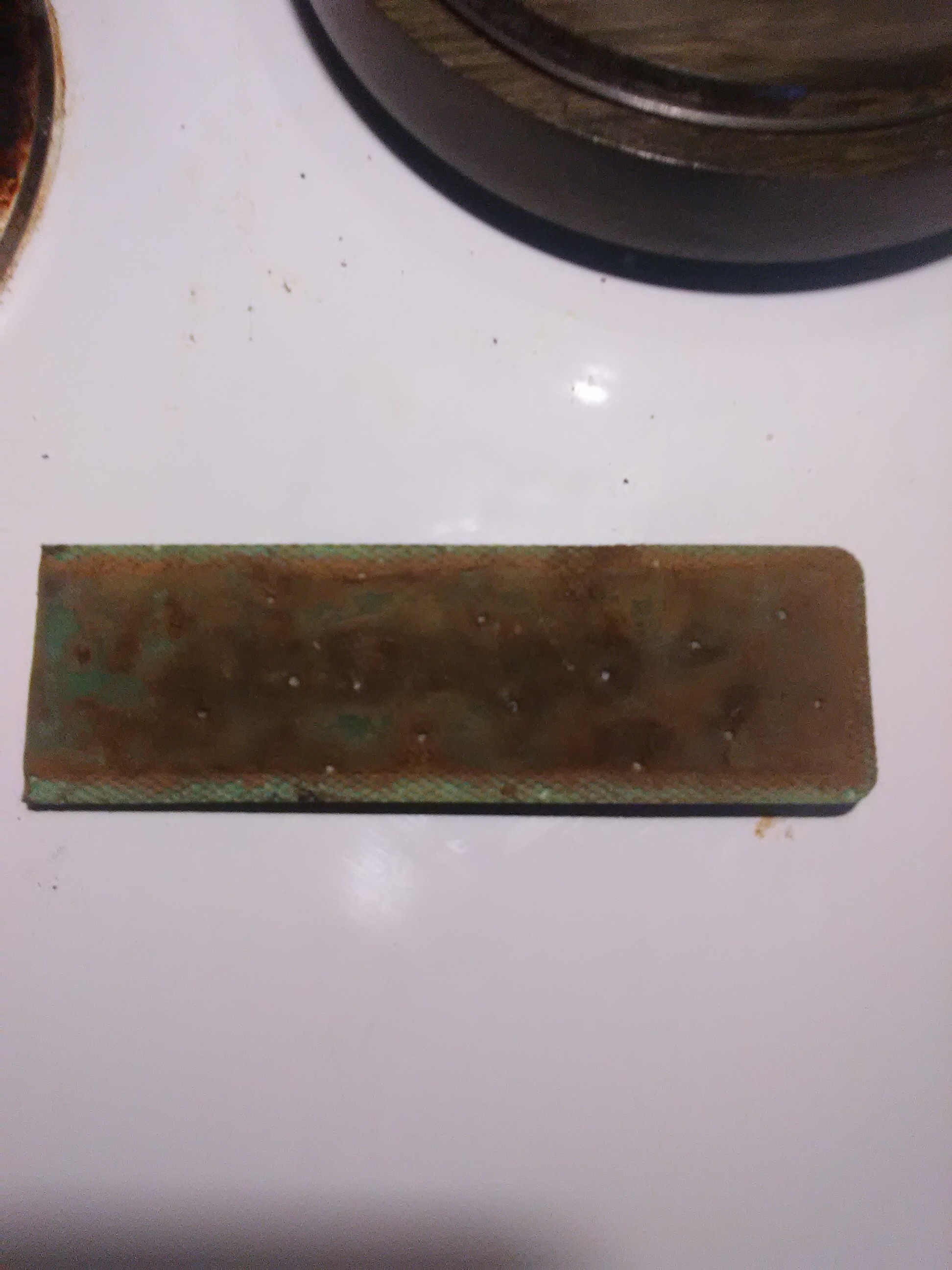

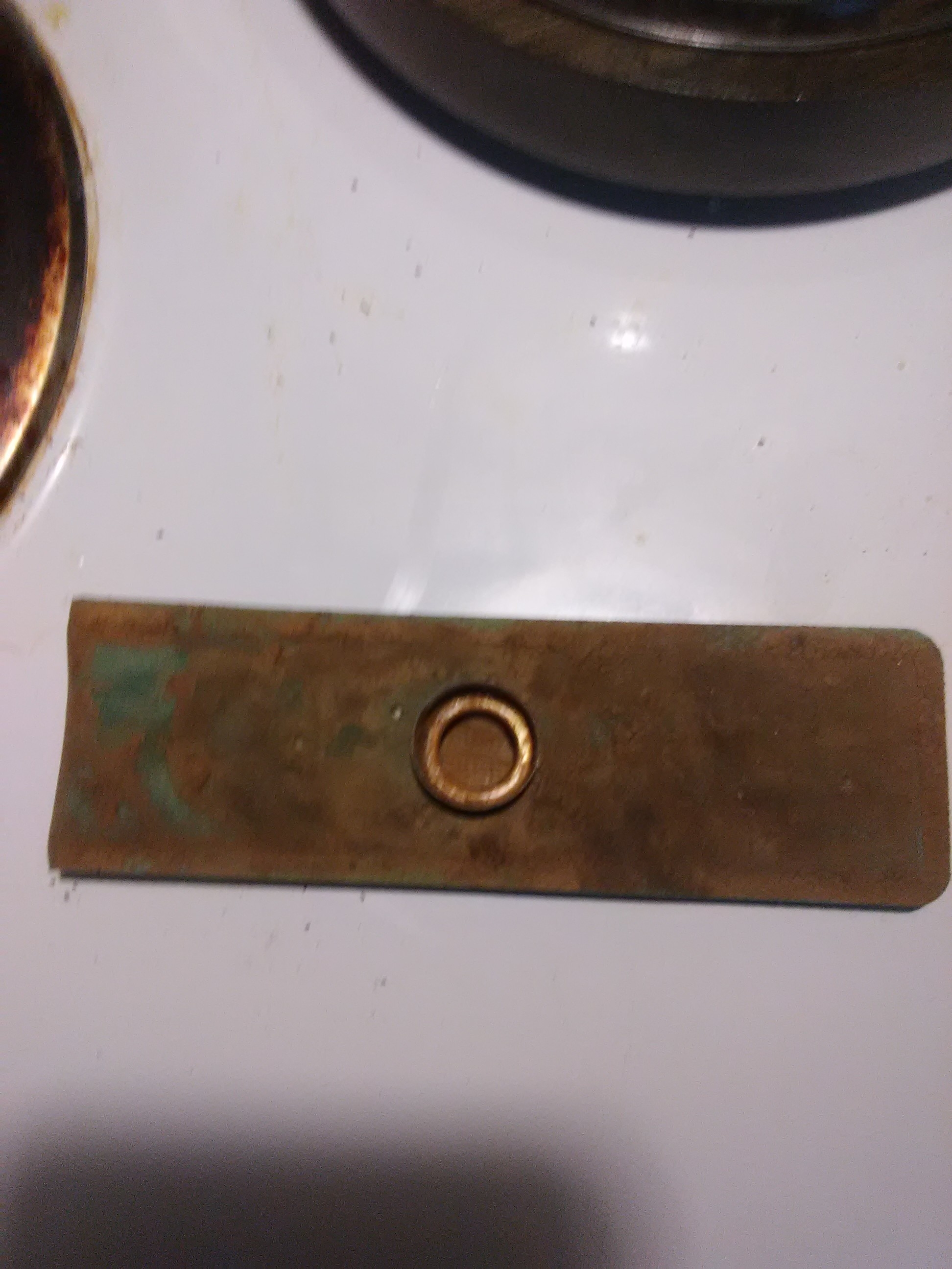

Alrighty so I have checked engine codes that is usually first thing I do when I encounter a problem with the obd1 I jump the ports to a and b and count the flashes but unfortunately no codes. So I did a little thinking and I think I came up with the diagnosis when I first got the Blazer he said it set for about one year or so and the pump was bad I will (include photo of the pump) and when I say this thing was shot I mean it was completely melted. So when I put the new pump in it it ran like a brand new one of course that is until the contaminated rusty gas got into it and ruined it. I dropped the tank and poured the gas out it was completely orange this tank is so bad no amount of acid is going to save it in the world that would explain the ruining of fuel pumps . Of course most cars do not have engine codes for faulty fuel pumps and the sender I think is still okay since I'm not having issues with the gas hand. So all in all I know I need a new tank that's for sure my question is would the rusty gas hurt the engine like damage the push rods and would you recommend a engine flush? And if so what do you recommend? Also I will include pump and filter photo. Thanks in advance.

Wow, that is a mess. I agree. As far as the engine, I really don't feel anything would have gotten into it that would cause harm. However, if the rust or dirt got past the filters, it could cause an issue with the injector. But you said you are getting a good flow.
I would suggest doing what you suggested. I feel that is the best place to start. If you can, when the pump is out, I would remove all filters and try to blow out the fuel supply lines from the engine back. Avoid blowing from the tank to the motor.

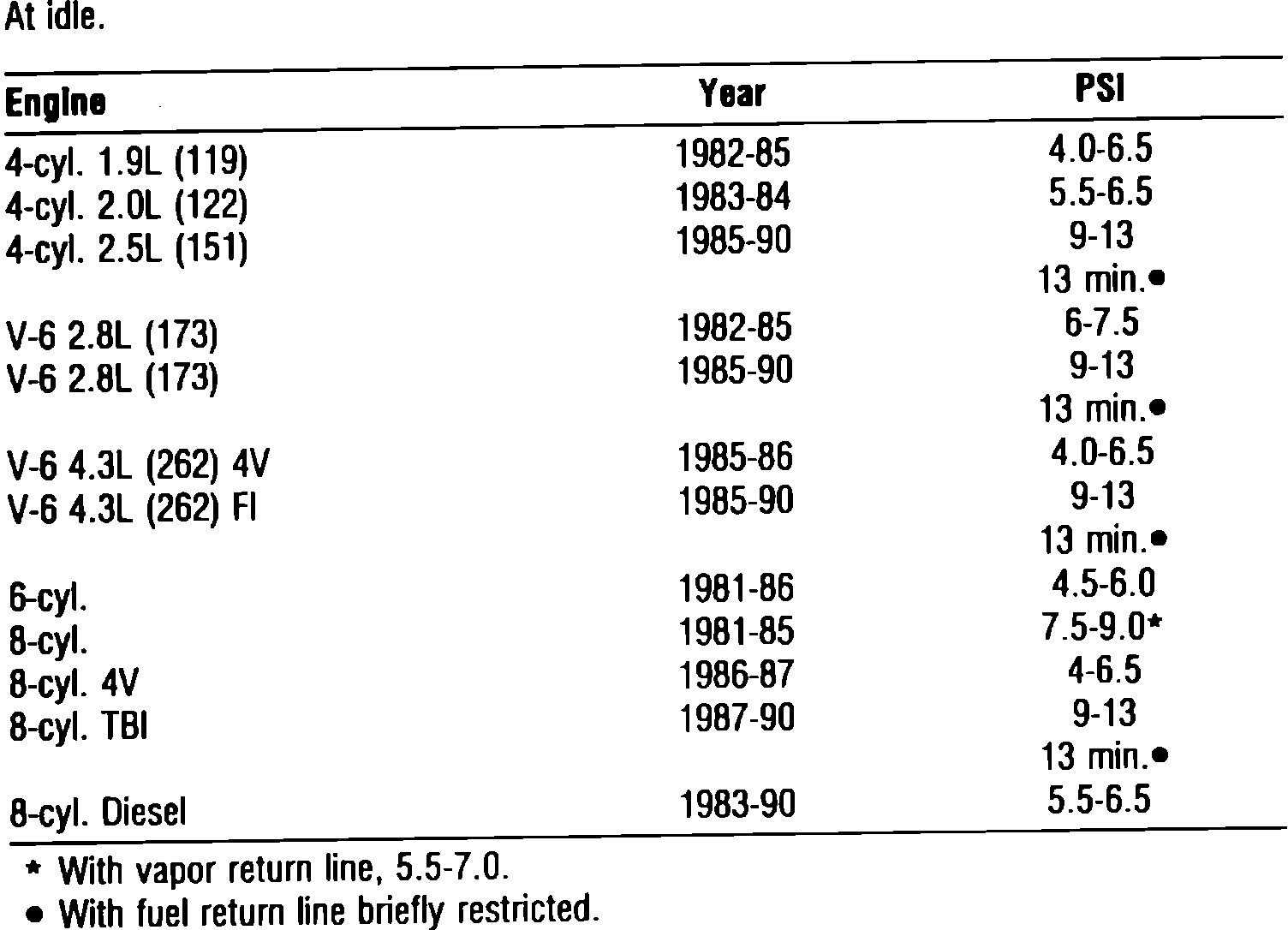

Regardless, I'm glad you got it going. Here are the directions for testing fuel pressure. It is with the engine running and at idle. They don't provide it any other way. I attached the required pressure specifications in picture one.

FUEL SYSTEM PRESSURE TEST
FUEL PRESSURE TEST
- Turn engine "OFF" and perform Fuel Pressure Relief procedure.
CAUTION: A small amount of fuel may be released, after the fuel line is disconnected. In order to reduce the chance of personal injury, cover the fitting to be disconnected with a shop cloth. Place the cloth in an approved container when disconnect is completed.
- Install fuel pressure gage J-29658A/BT8205, or equivalent, at the outlet side of the in-line fuel filter.
- Start engine and observe fuel pressure reading. It should be 62-90 kPa (9-13 psi).
- Relieve fuel pressure.
- Remove fuel pressure gage.
- Re-install fuel hose or pipe assembly to in-line fuel filter.
- Start engine and check for fuel leaks.
*** THIS PROCEDURE HAS BEEN UPDATED BY TSB # 90-6C-89, Dated 9/90
