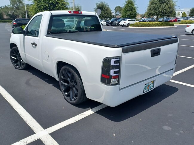

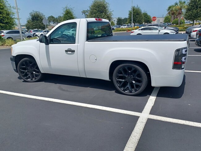

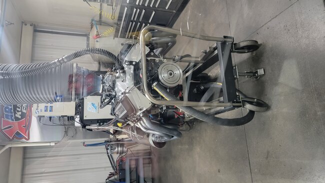

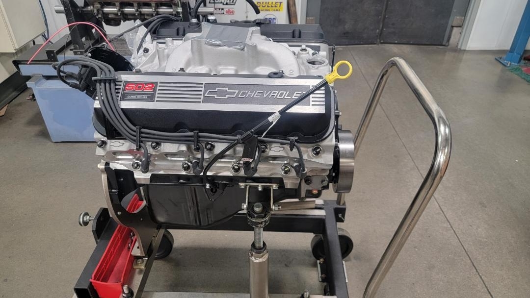

Ryan, I'm swapping the V6 engine in my 2011 Sierra 1500 series WT with a Chevrolet Performance 501ci / 8.2 liter with a 4L85E transmission, 3,000-3,400 RPMs stall. That entire package is the Connect/Cruise, really slick.
Question. Questions
Headers. I can find 304 stainless long or short tube headers for the 2500 series.. of course I can't find BBC headers for the 1500 series.
Fit? I understand some headers will hit the lower head bolts and that may require grinding on the header flange.
How do I find a header that will fit inside the frame rails, are they the same/similar width (1500 vs 2500)? Is it trial and error?
recommendation? Short? or long tube? Oh, I have a 4 inch drop up front and 6 inch in back. I think there's no clearance issue.. tubes will be above the frame.
Worst case? Factory Cast manifolds, there's a Camaro type and a Corvette type that looks like it will flow better. Am I stupid to use cast manifolds? It did dyno at 614 foot pounds and 514 hp so I'd be giving up just a little. Your opinion?

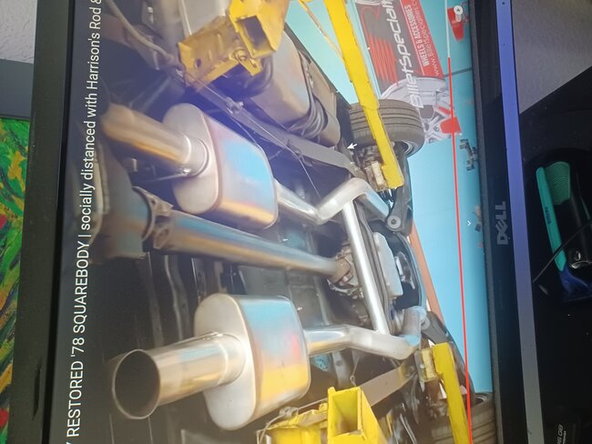

Exhaust system? Planning 3 inch (or 2.5 if I go cast manifold) to Flowmaster 50 with an H-pipe dumping before the axle.

That is one super cool build you have there! I have never seen someone put a big block Chevy in a late model Silverado. I love it! But because it is a more unique combination it will be very difficult to find long tubes that will work. You might have to get some headers custom made at pretty high expense. A big block Chevy is physically a much larger engine than a typical LS based engine so that means header and exhaust are always going to be a challenge.
Long tube headers are where you are going to get the very best performance. However, bang for buck the cast manifolds are just fine, I probably would not bother with short tube. You are not losing that much and if they fit, look nice, get your truck on the road. That is a win in my book!
