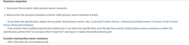

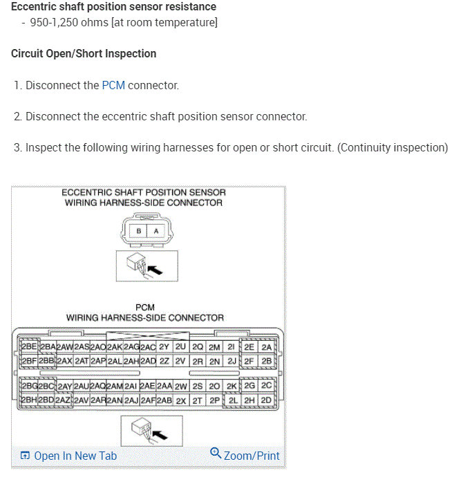

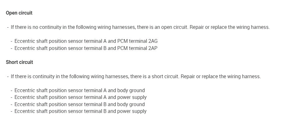

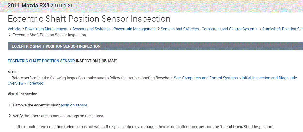

When you checked the eccentric shaft position sensor, was the vehicle in a no-start condition? What you described sounds like that is the issue, so I just need to confirm that with you.
If it wasn't, I attached the diagnostics specific to the sensor. Take a look through them and let me know if you are comfortable performing them.

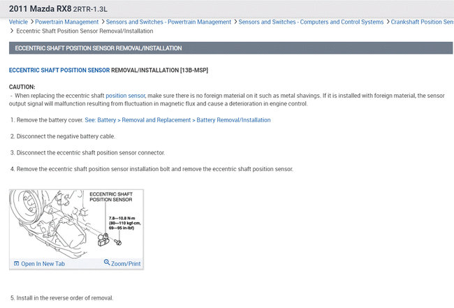

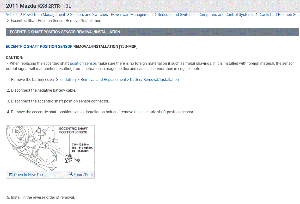

Additionally, the last pic includes the directions for the replacement of the sensor if needed.
