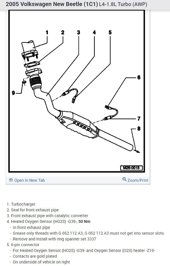

rusted flex pipes on catalytic convertor makes a loud noise
Oct 3, 2014 at 6:39 PM
SQM
  • 6,383 POSTS
When a flex pipe goes bad it will need to be replaced as they are not repairable.
On this Beetle the flex pipe and the catalytic converter comes as a single unit and gets replaced together.
Here is a helpful guide of replacing catalytic converter:
https://www.2carpros.com/articles/catalytic-converter-replacement
I have attached the diagram for your reference.
