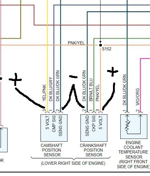

So I tested the wiring that goes into my crankshaft sensor and got a voltage of 3.5. Does that mean my wiring is okay?

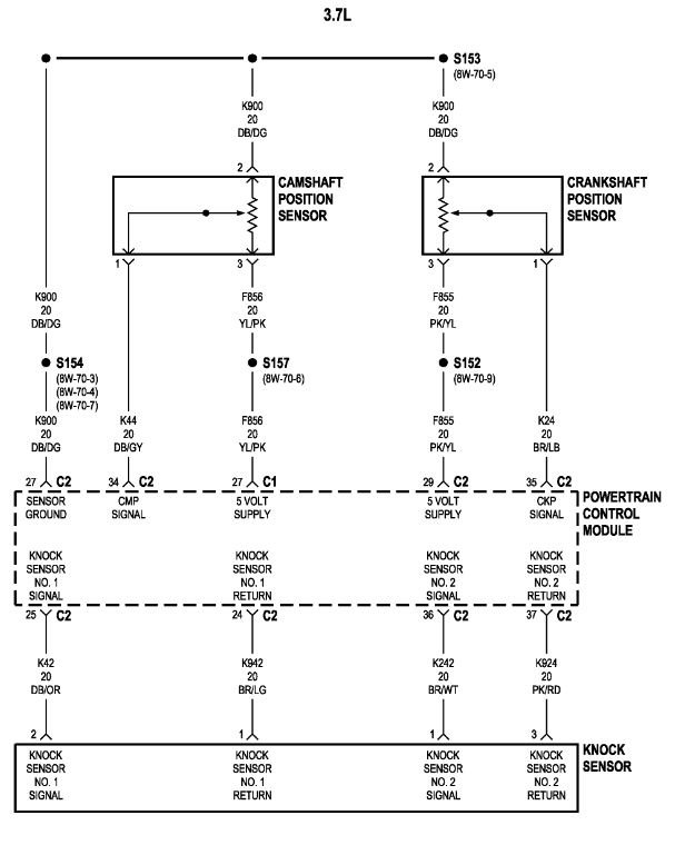

3.5 is very low. That could be the entire problem. You should be able to measure 5 volts or very close to it. Measure between the Dark Blue wire with a Dark Green trace and the Pink with Yellow trace wire with the key on. You want to see 5 volts. Then go to the cam sensor and check between the Dk Blue w green trace and the Yellow wire with pink trace That should also show 5 volts. If not you have a problem. The Dk Blue wgreen wire is the ground side, the others are 5 volt reference feeds from two different connection pins. The other wire on each sensor is the signal output. If you find 5 volts at the cam sensor but still 3.5 at the crank sensor, take the negative probe and put it on the negative battery terminal and then measure the crank signal voltage again. If it's still 3.5 then the ground side is OK and the problem is on the feed side.

As far as the wiring, It would depend on what it actually is. If you measured the voltages and found one is 5 volts and one is 3.5 then it may be just a corroded connection at the PCM. Or it may be internal to the PCM. That was one reason I wanted you to measure them both and to ground as well.

Still struggling over here with my sensor! I got my hands on a nice scanner tool, my buddy let me borrow it. It's a CPR 123. I used the scan tool on the Chrysler setting and tested the Cam Crank difference with the car running. It was jumping between 3.8 and 4.2 ish and it jumped to 4.6 when I revved the engine. Does that sound good? My father said he's confident it's the sensor. Because it is an intermittent code, he said he is confident it's the sensor stalling out on me. I know you're confident it's a wiring issue, what does that difference value mean to you?
I know I told you I got a 3.5 V reading on the connector and you said that it was low, but maybe it was inaccurate? Curious to hear your input on this, and this CPR 123 is new to me. I see a few other cam / crank options to test. Let me know if anything else would be useful to test. Thanks!

Intermittent codes can be wiring or part, that is why you test both. In this case I would say it's the wiring simply because of the readings you are getting and it being a Jeep that are known for wiring and ground issues. If you think the voltage was wrong, test it again. You should have real close to 5 volts there, low voltage will cause the sensors to work intermittently if they work at all.
