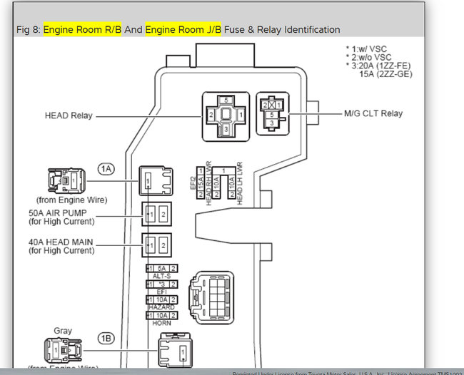

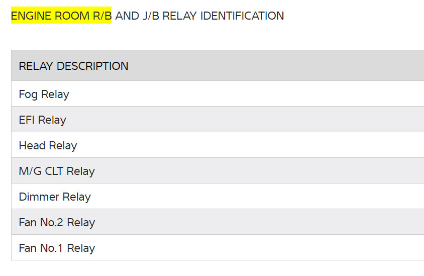

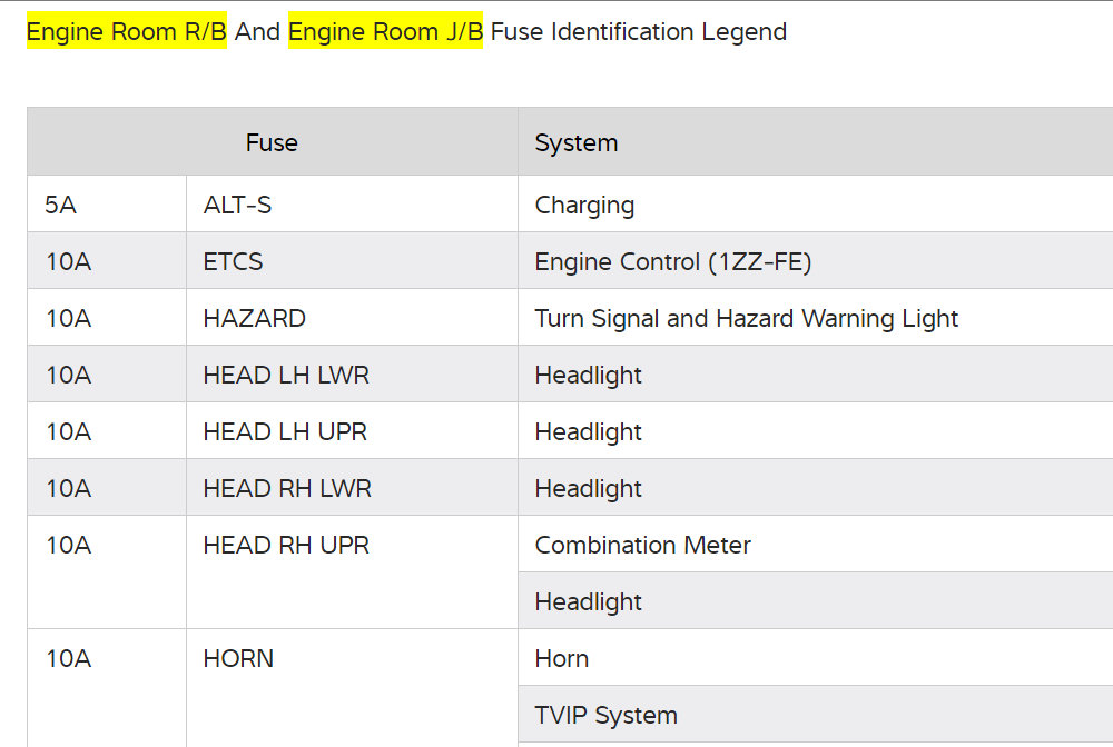

Hi there guys, I really need some advance. I connect my car battery wrongful and after the that I my car dashboards, radio, emergency lights, air-conditioning and gauges didn't work. the car did start normal, but my battery light did stay on. I checked my fuses and replace all of them and its still not working. Then I checked the 100A fuse and found out is blown. can that be the problem guys?
Jul 7, 2019 at 8:32 PM
SCGRANTURISMO
  • 4,897 POSTS

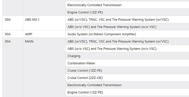

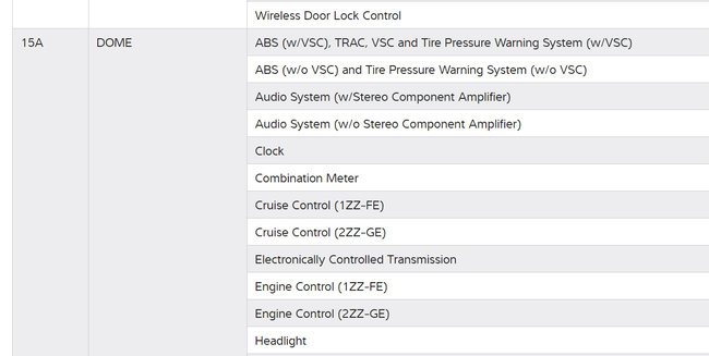

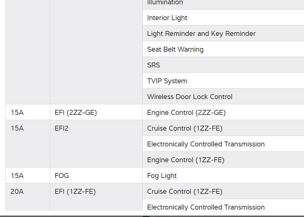

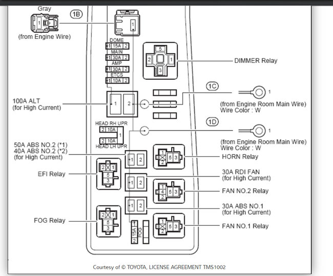

It could be the cause of some of your vehicle's symptoms. In the diagrams down below I have included a diagram with callout for your vegicle's Engine Compartment Fuse/Relay Box. Please go through this guide and determine what controls what and get back to us with what you are able to find out.
Thanks,
Alex
2CarPros
Jul 7, 2019 at 9:08 PM

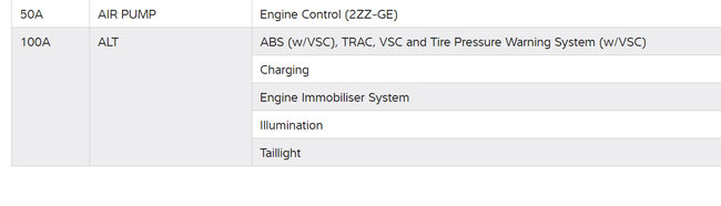

LUANTONS
Hi guys, I replace the main fuse 100Amp and that was the problem but my battery light didn't switch off. I drove a few miles and it still stayed on. I switch off my car and lock my door and the next day my doors don't want to unlock. what could be the problem now? Also, my car is making a weird sound what could be the problem off that? here are a video. guys, thank uou so much for your help.
