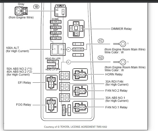

Hi there guys, I really need some advance. I connect my car battery wrongful and after the that I my car dashboards, radio, emergency lights, air-conditioning and gauges didn't work. the car did start normal, but my battery light did stay on. I checked my fuses and replace all of them and its still not working. Then I checked the 100A fuse and found out is blown. can that be the problem guys?

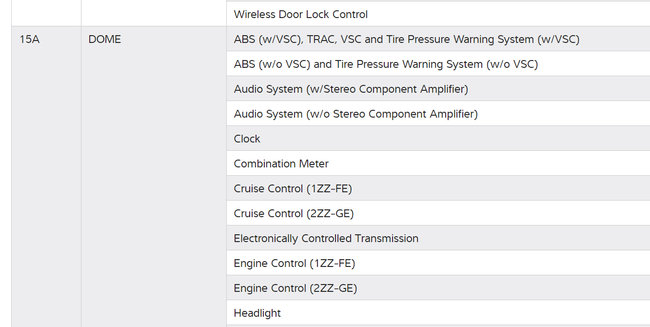

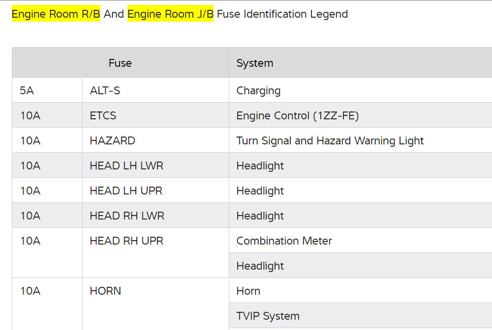

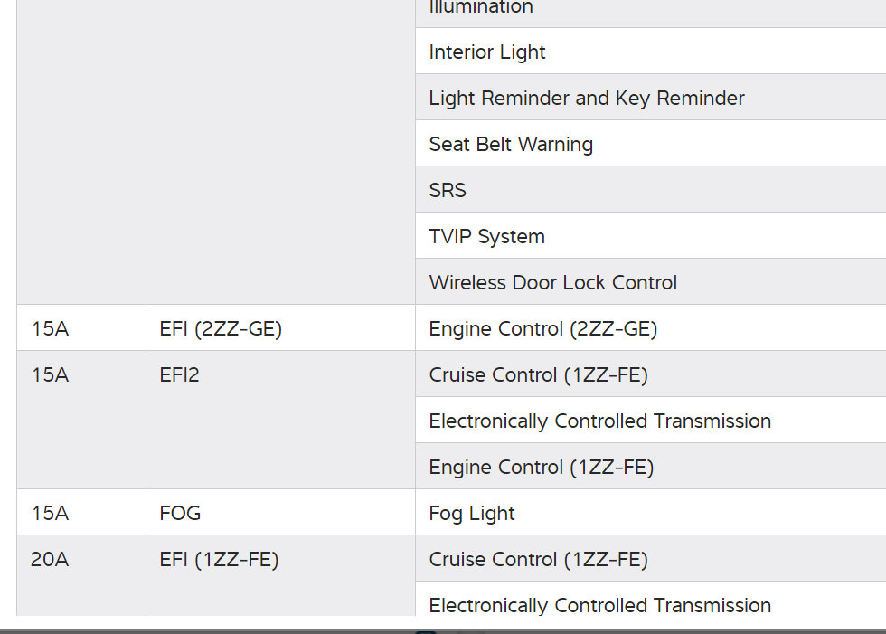

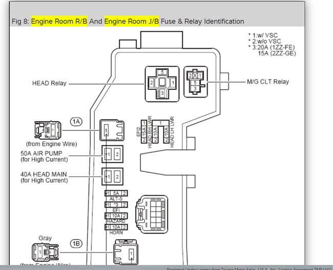

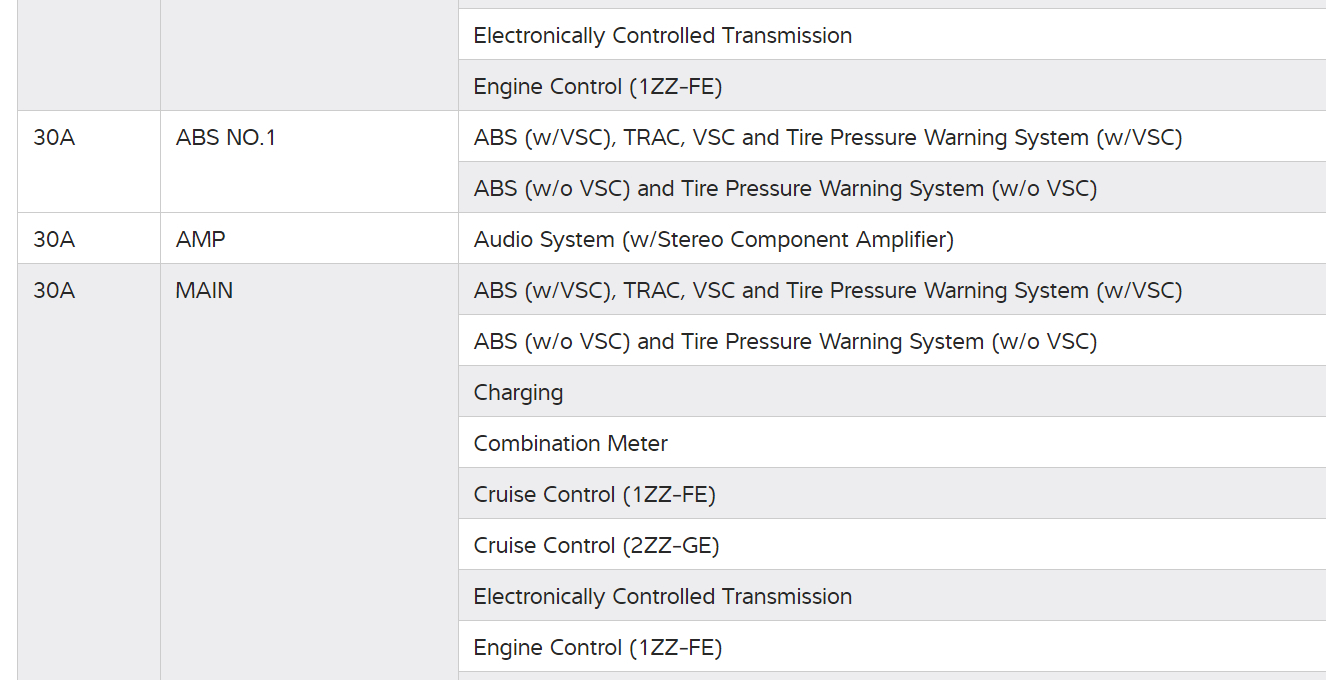

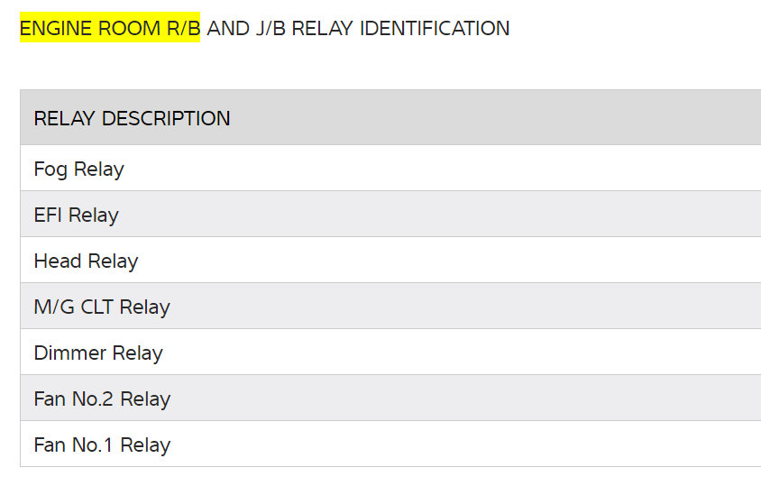

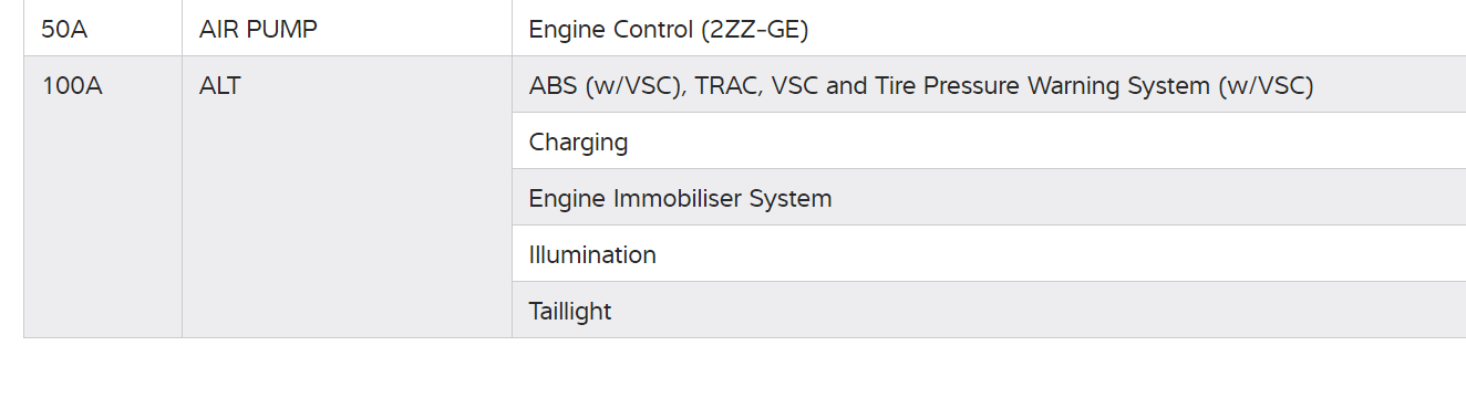

It could be the cause of some of your vehicle's symptoms. In the diagrams down below I have included a diagram with callout for your vegicle's Engine Compartment Fuse/Relay Box. Please go through this guide and determine what controls what and get back to us with what you are able to find out.

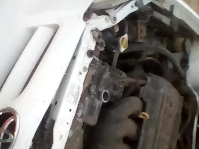

Hi guys, I replace the main fuse 100Amp and that was the problem but my battery light didn't switch off. I drove a few miles and it still stayed on. I switch off my car and lock my door and the next day my doors don't want to unlock. what could be the problem now? Also, my car is making a weird sound what could be the problem off that? here are a video. guys, thank uou so much for your help.

That sounds like something is loose and rattling around. Have you checked your alternator yet? This might be the bearing in your alternator pulley going out and that might be why your battery light is illuminated. Here are a couple of links down below for you to go to:
