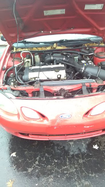

Runs rough like its running out of gas.
JOSEPH ELASTER
  • 1998 FORD ESCORT
  • 2.0L
  • 4 CYL
  • 2WD
  • MANUAL
  • 127,000 MILES
So I have a 16 valve Zetec engine with approximately 127,000 miles on it. The problem I am having with it which I hope is something simple, is when I give it gas it goes but if I give it too much gas it feels like it is running out of gas, but there are no leaks or any of that. My oil does smell like gas but the car runs and does not stall or turn off on me.

Scan for codes and check fuel pressure with a gauge auto parts rent it . see link.

Hi Joseph,
here is a link to an article that features written step by step instructions and pictures explaining how to do the scan yourself, also I have included a link to our YouTube channel with a how to video on code scanning.
This is applicable even if your check engine light is not on.
Most scanners are inexpensive to purchase, you can purchase one online auto parts stores.
https://youtu.be/YV3TRZwer8k
Once you have the codes please get back to us so that we can further assist you. We are always happy to help.
