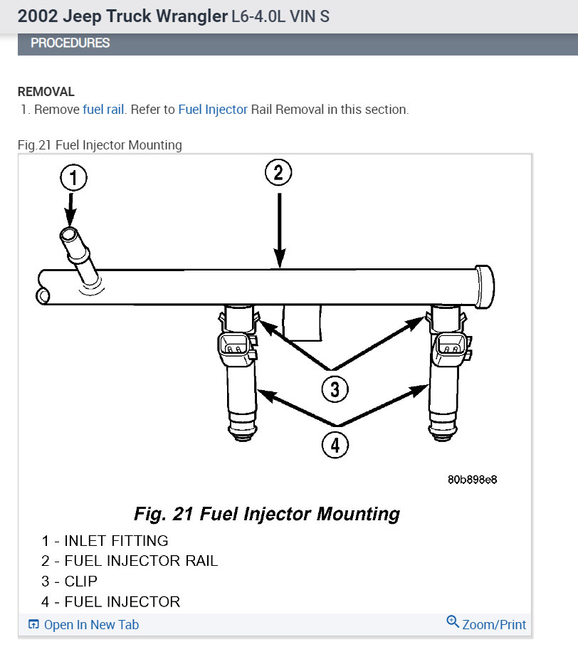

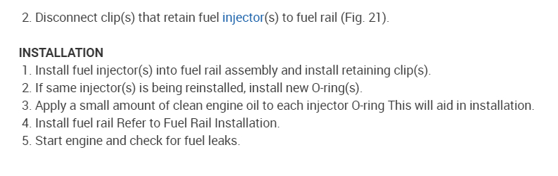

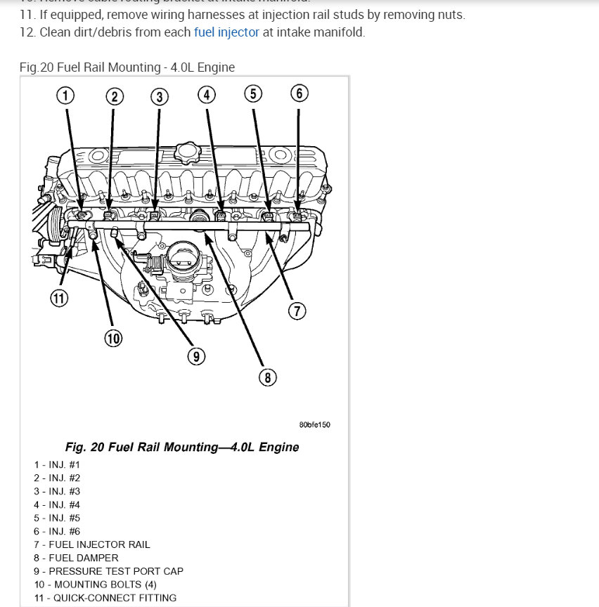

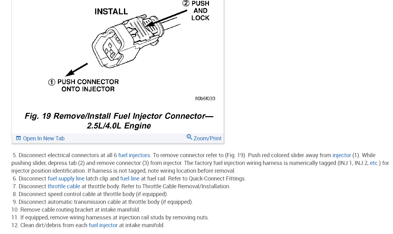

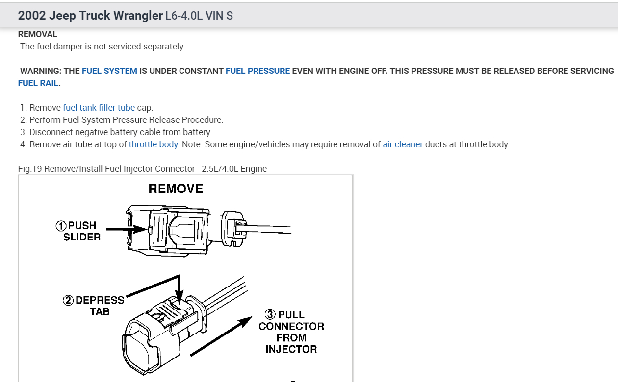

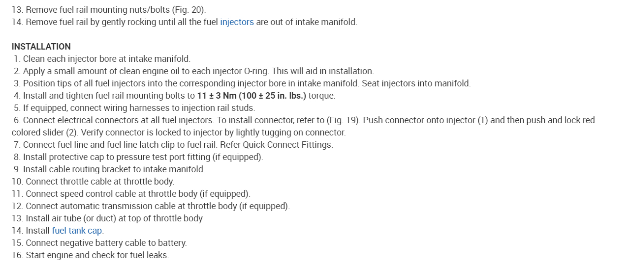

Nice work, I would replace the #2- and #3-cylinders fuel injectors.
Here is a generic guide to show you how with instructions below to show you on your car:
https://www.2carpros.com/articles/how-to-replace-a-fuel-injector
Check out the images (below). Please let us know what happens. Don't forget to replace the oxygen sensor.

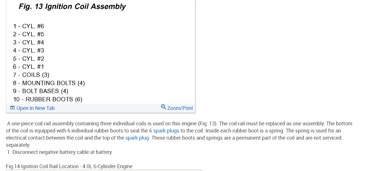

I should have mentioned it, but I already changed the injectors also. Is it possible to have a weak spark off the ignition coil? I have spark on every plug, but I’ve had a couple of people tell me it can have a weak spark.
Oct 5, 2022 at 2:24 AM
  • 55,224 POSTS
Yes, definitely a weak spark can cause the problem.
Oct 6, 2022 at 3:53 AM
CLINT JANES
  • 5 POSTS
with all the stuff I’ve changed already, would an ignition coil be what you tried next?
Oct 6, 2022 at 6:01 AM

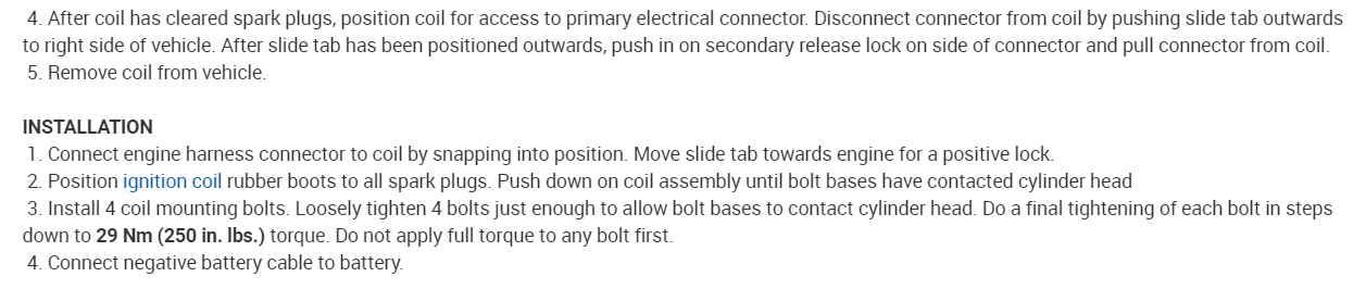

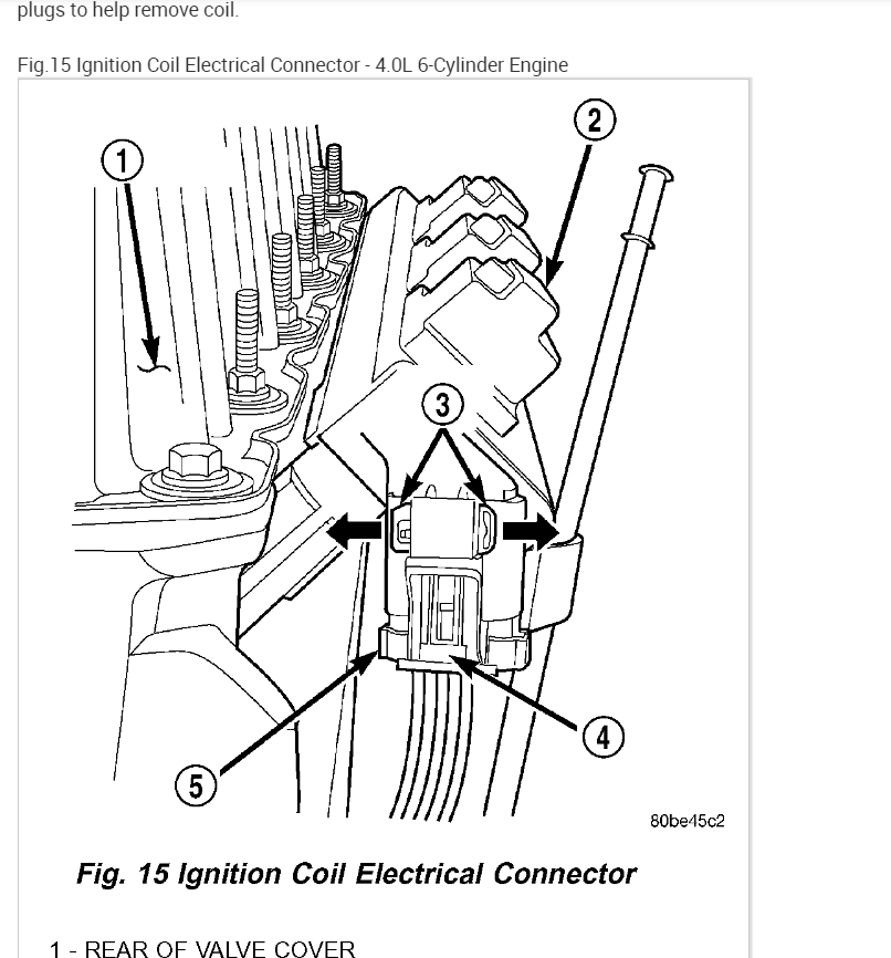

  • 55,224 POSTS

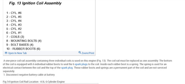

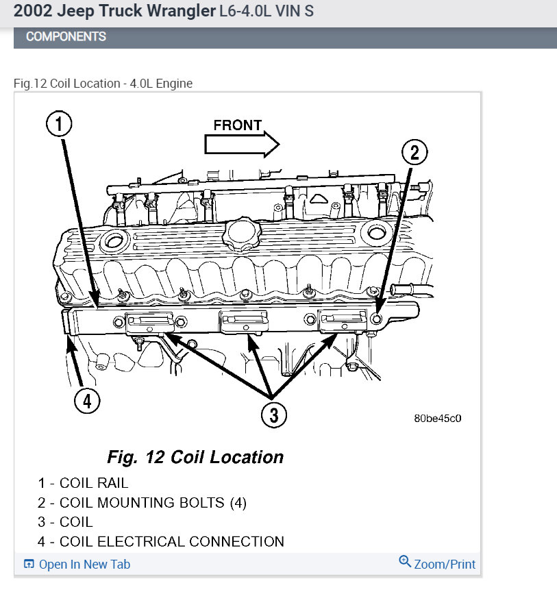

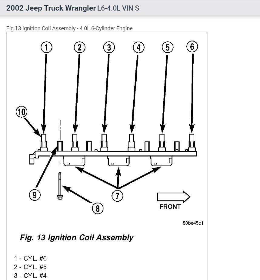

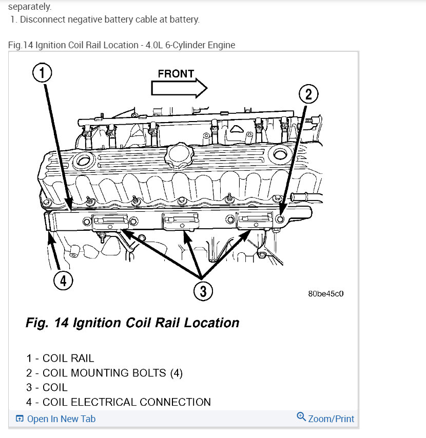

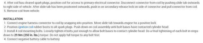

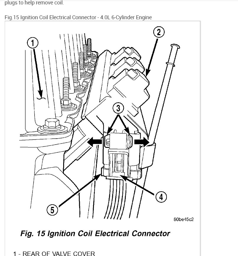

Yep, that is where I was going next here is how you can change out the ignition coils in the images below. Check out the images (below). Please let us know what you find.
Oct 7, 2022 at 8:25 AM
CLINT JANES
  • 5 POSTS
It was the ignition coil causing the problem. Thank you so much for your time. I really appreciate it.
