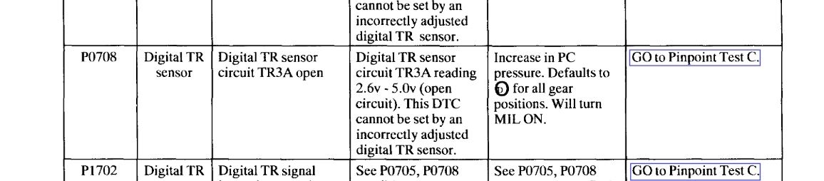

Koeo codes po113/ po118/ po123/
Po453/po708/ po713/
P1000/p1401/p1565/p1702
Koer codes. Po113/po118/po123/po708

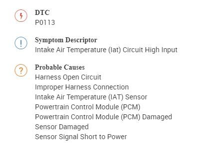

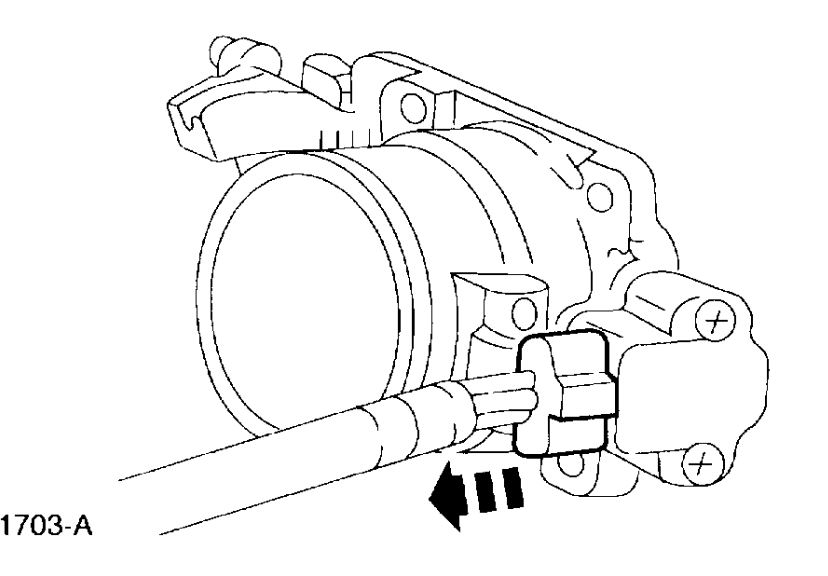

The 113 is intake air temperature sensor. It is located on the intake hose from the mass air flow to the throttle body.
https://www.2carpros.com/articles/replace-an-air-intake-boot

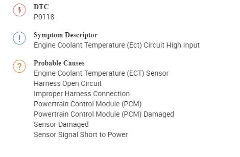

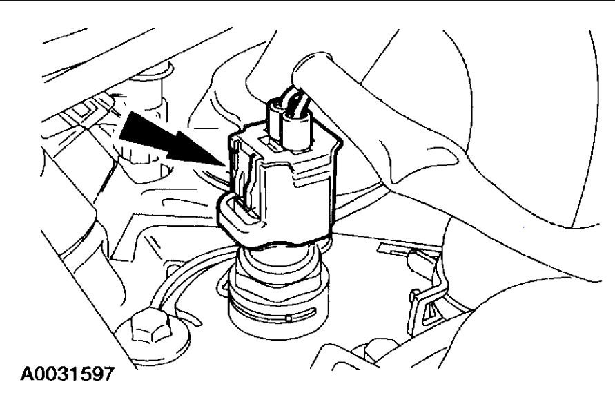

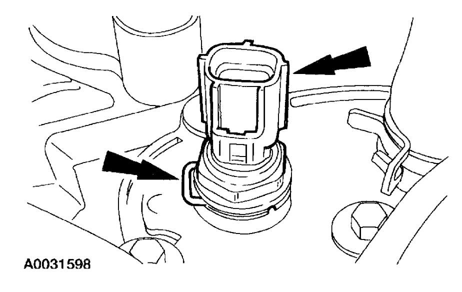

118 is for the coolant temp sensor. It is located by the thermostat housing. It is a 2 wire sensor.
https://www.2carpros.com/articles/coolant-temperature-sensor-cts-replacement

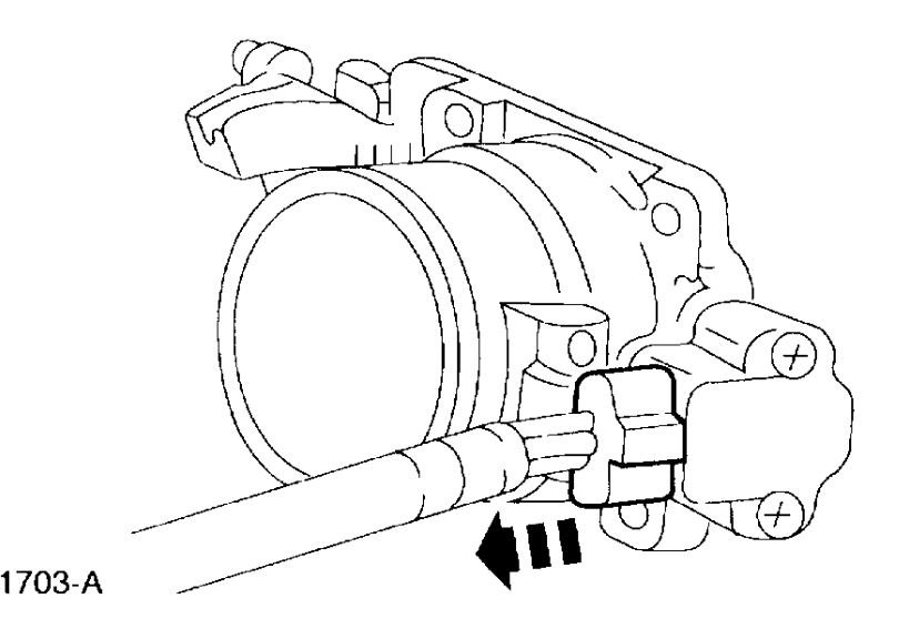

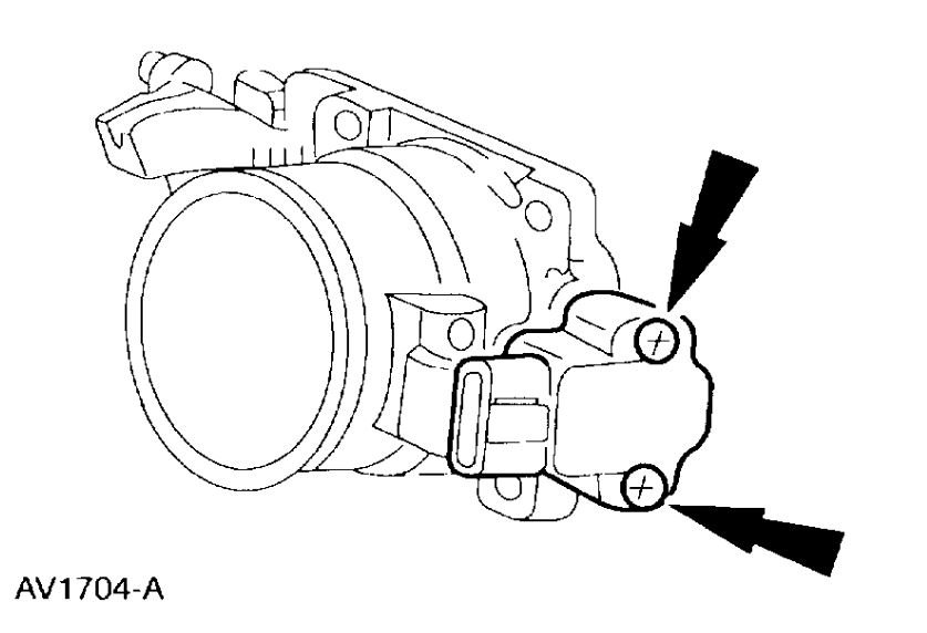

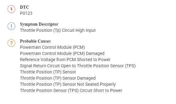

123 is for the throttle position sensor?

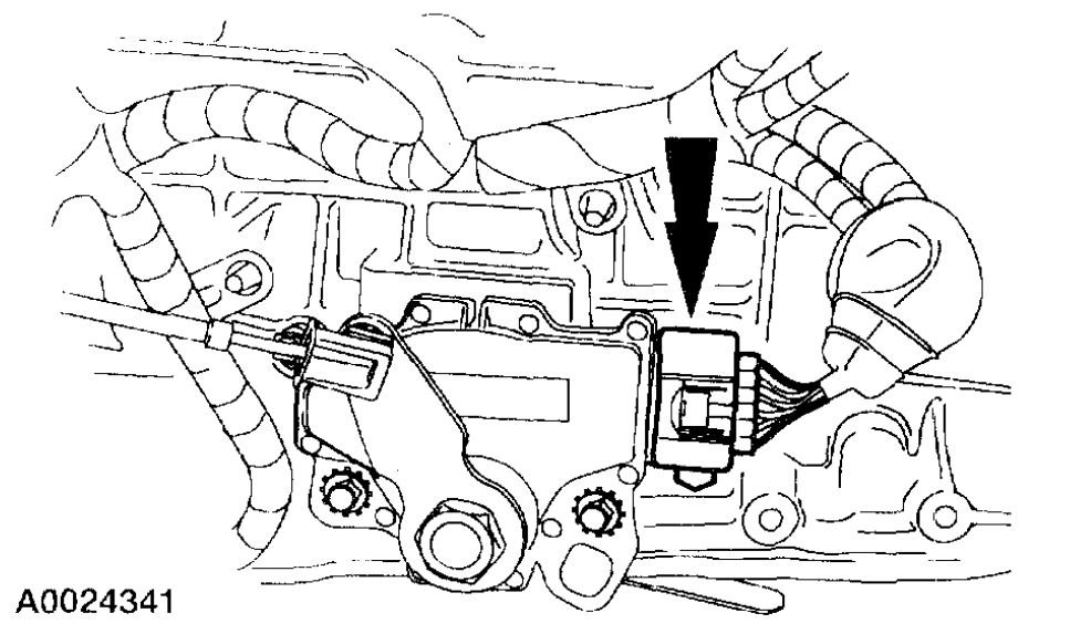

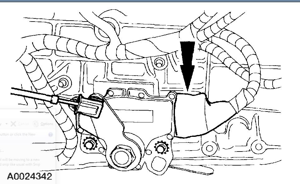

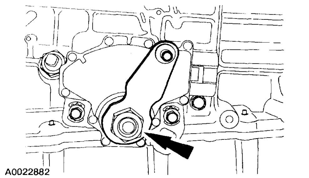

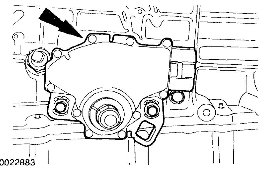

The 708 is for the transmission range sensor on the side of the transmission.
https://www.2carpros.com/articles/how-a-neutral-safety-switch-works
