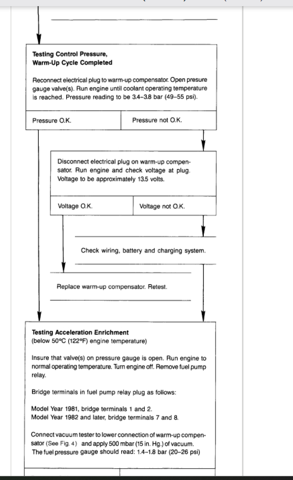

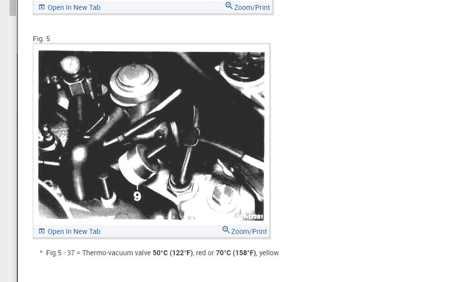

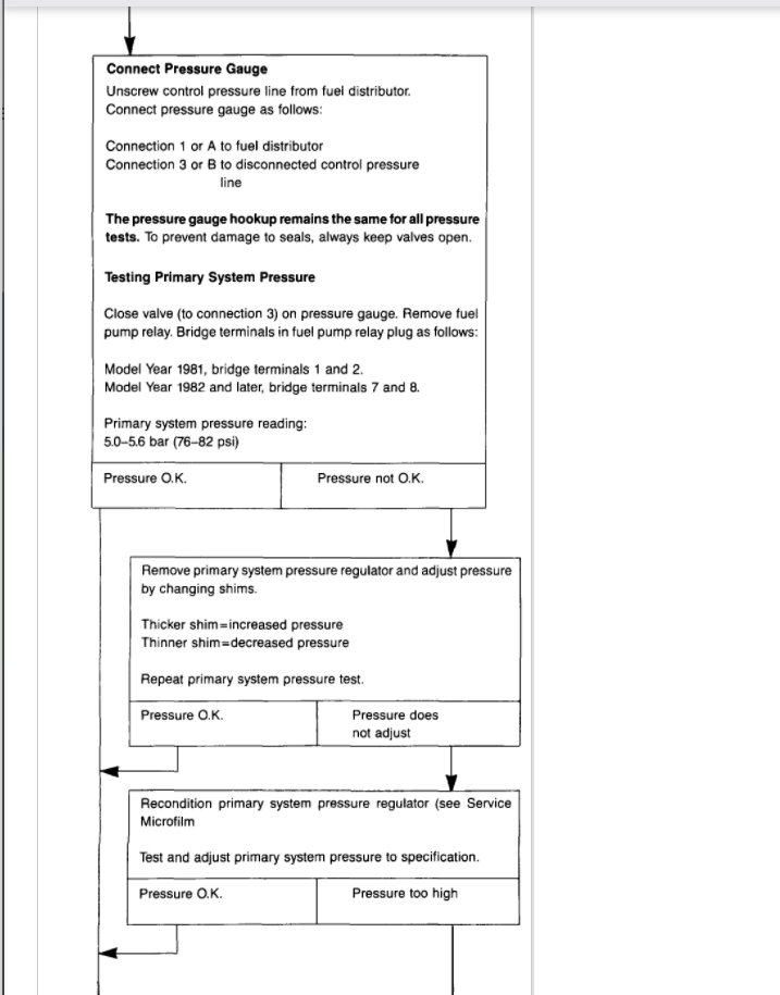

After rebuilding fuel delivery system, replacing injectors, cleaning fuel lines from distributor to injectors, adding new plugs and wire set, the car will start, but only runs for a few seconds. Not sure what my next step(s) should be to address this issue. Thanks, Dave
Jun 21, 2021 at 9:41 AM

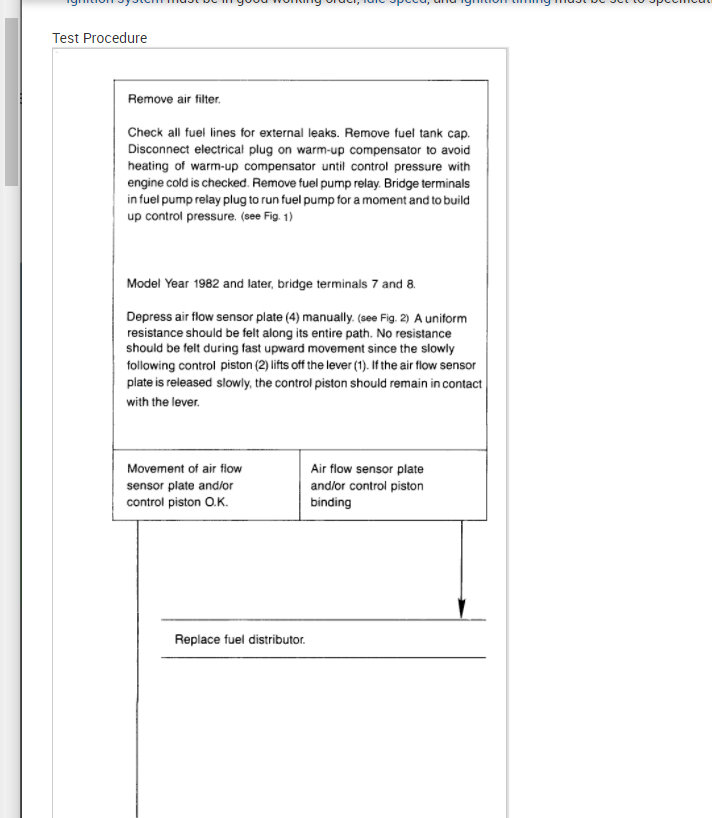

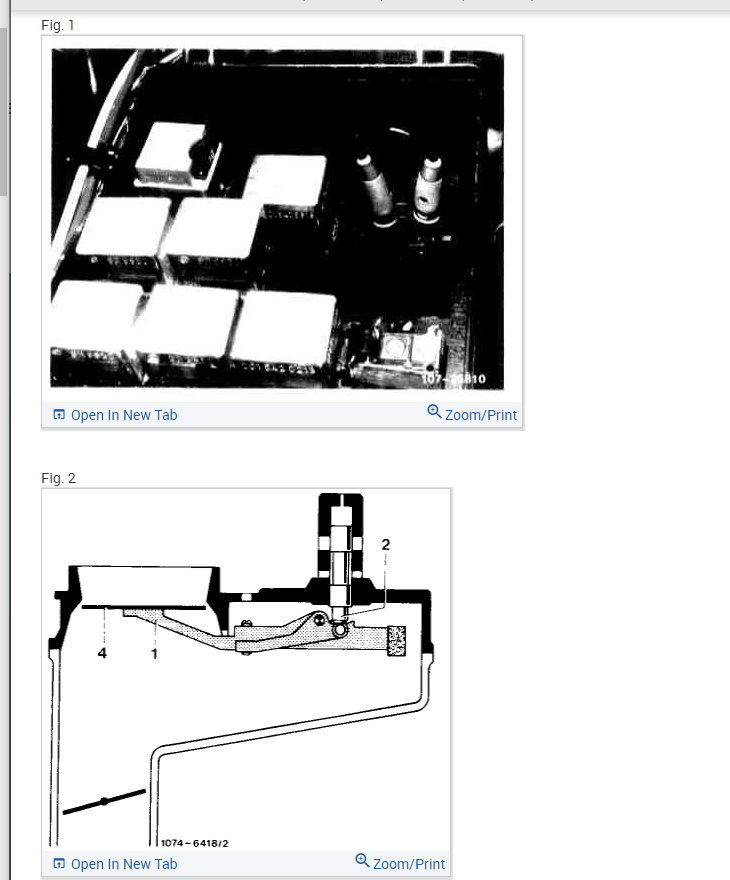

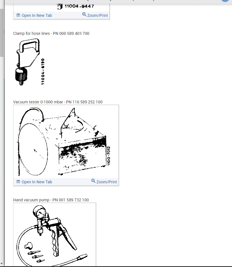

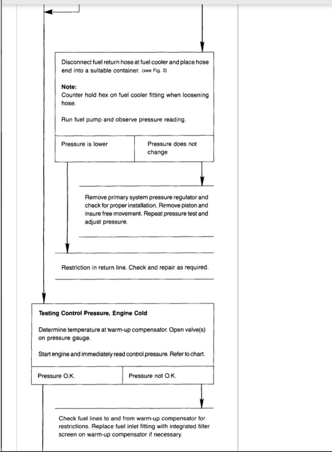

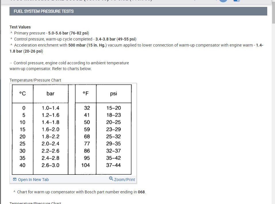

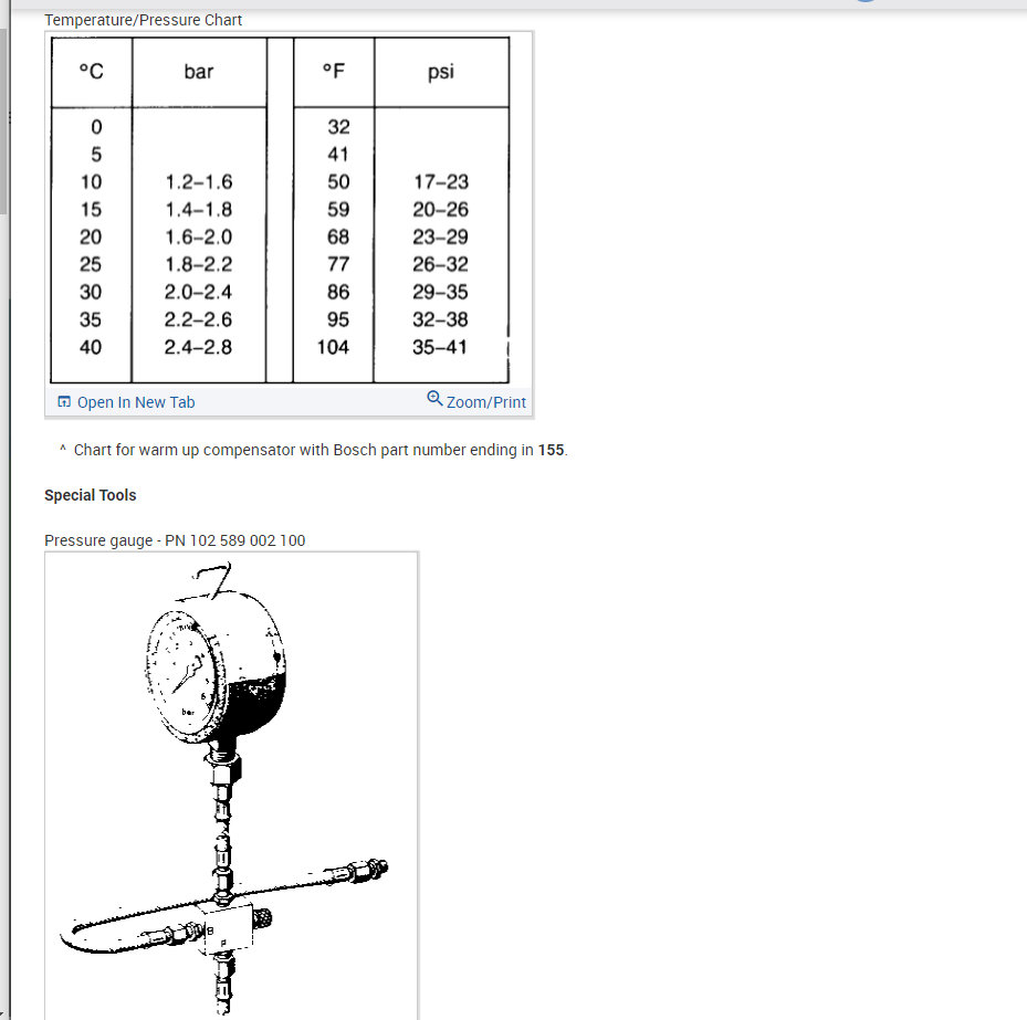

This sounds like a fuel issue so we need to start with checking fuel pressure and finding out what it is. Especially since you just did all this work to the fuel system.
Here is a guide that will help with step by step instructions on this:
Next here is a guide that helps with this issue in more general terms:
Let's start with this info and go from there because once we find out the fuel pressure, I suspect we are going to be onto our issue.

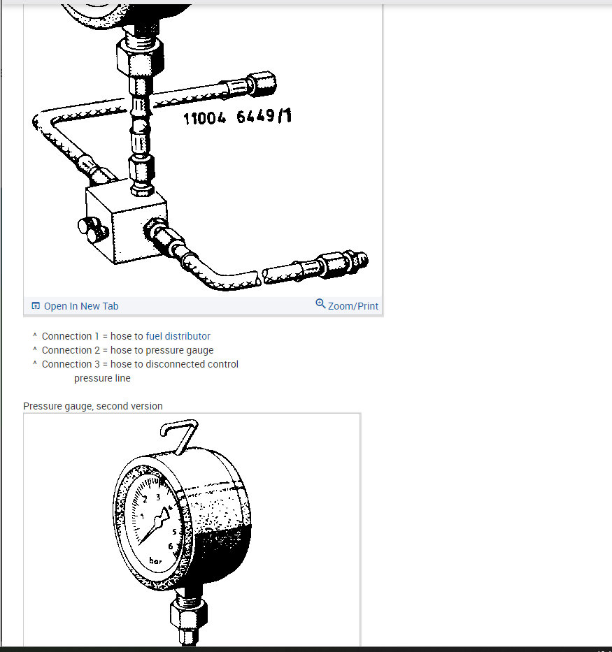

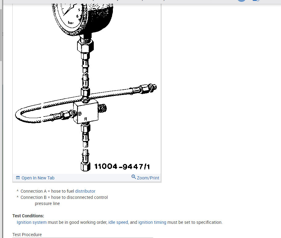

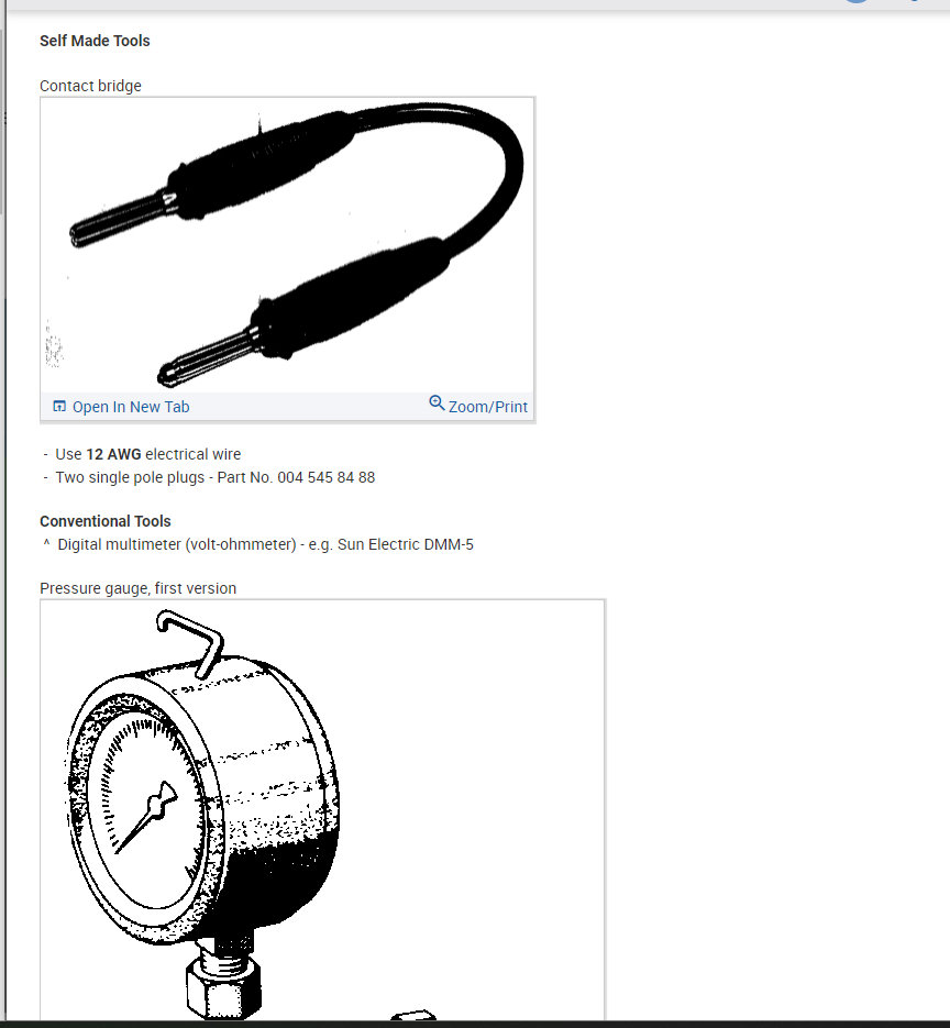

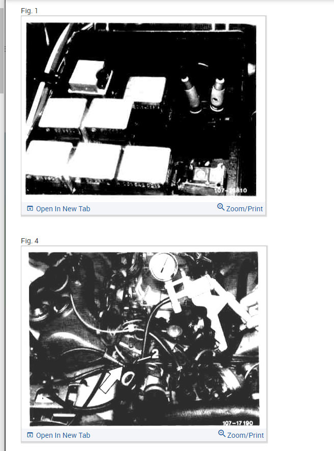

Thanks. Not sure where to attach the pressure gauge. There is no port on the fuel distributor and there is no pressure port on any line in an old car like this. Should I attach it on the line from the fuel pump before the distributor? Inline near the idle control module or the cold start control? Thanks.
Jun 24, 2021 at 3:26 AM

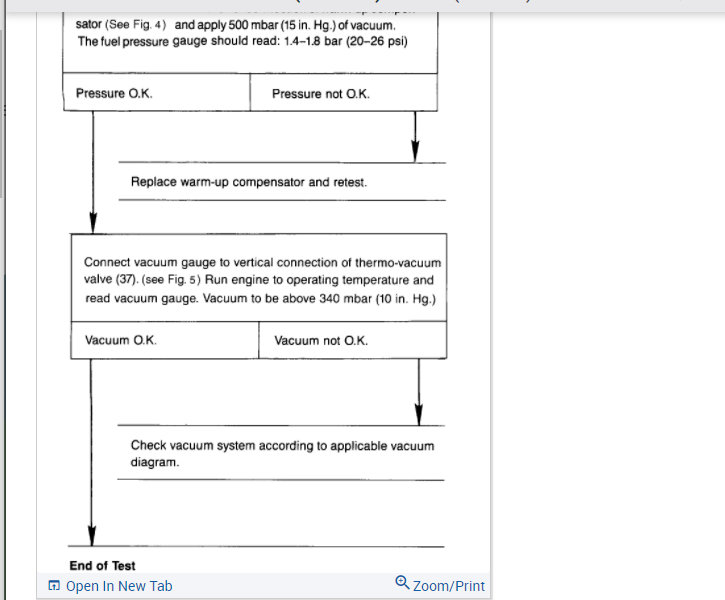

Unfortunately these are not easiest to test this pressure as you have to have basically separate a connection point and put in a T system as shown in the diagrams below.
These are not the best pictures but basically you have to pick any hard line connection point and put this set up in so that you can connect the gauge.

Thanks. I kind of figured I'd have to build my own lines with a tee and pressure port. I'll work on that. :)
