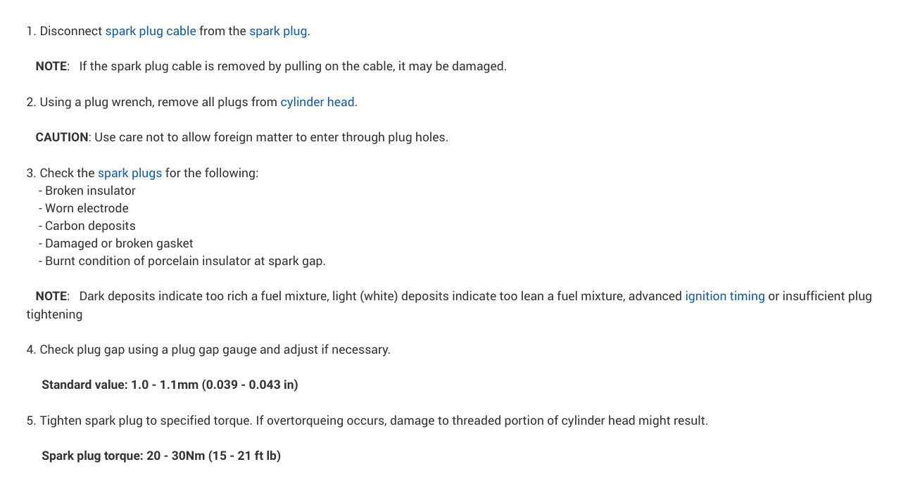

Runs but barely put my foot on the gas and it shuts off
1993 MITSUBISHI MIGHTY MAX
200,000 MILES • 3.0L • V6 • 4WD • MANUAL
MIGHTY MAX 1993
I just dropped and cleaned my tank out got a new fuel pump, but i can't figure out what is wrong in my vehicle.
Dec 30, 2019 at 12:06 PM
SCGRANTURISMO
  • 4,897 POSTS

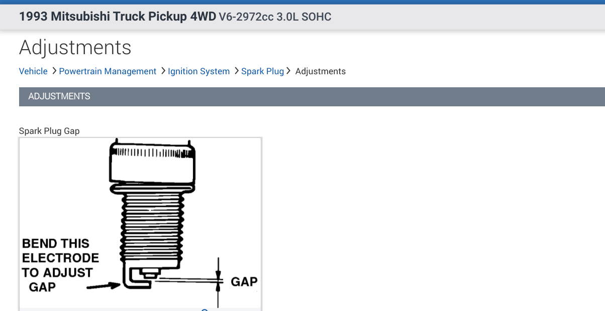

This could be a multitude of problems, so we are going to have to do a process of elimination here. So lets start with your vehicle's spark plugs. Can you please replace the spark plugs for us and get back to us with how everything turns out. In the diagrams down below I have included the instructions including the gap and torque specs in the diagrams down below for you. Happy Holidays.
