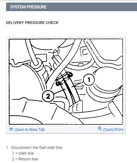

The problem came up suddenly. Won't hold an idle, bogs down when throttle is open. Stalls. Strong fuel smell and black smoke from exhaust. Starts quickly. Passed the smoke test. Cleaned EAC valve and tested it with battery power. Cleaned throttle body. No codes except one knock sensor out of 4, which has existed for years.
Mar 16, 2023 at 7:26 AM
  • 110,248 POSTS

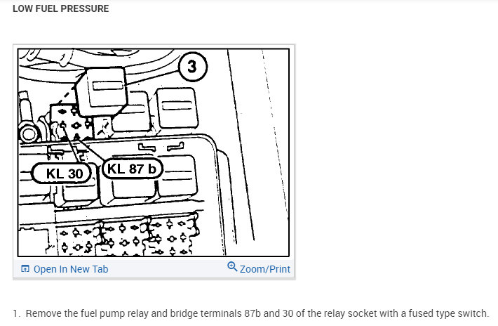

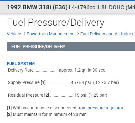

If you smell fuel and there is black smoke, the engine is getting too much fuel. The first thing I suggest is to check the fuel pressure. If it is excessive due to a faulty pressure regulator, it can cause this.
In addition to testing the pressure, when you turn the key off, pay attention to see how quickly the pressure drops off, and let me know what you see.
If you look below, I attached the manufacturer's fuel pressure specifications.

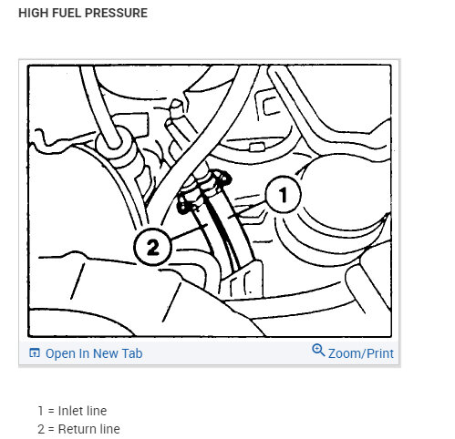

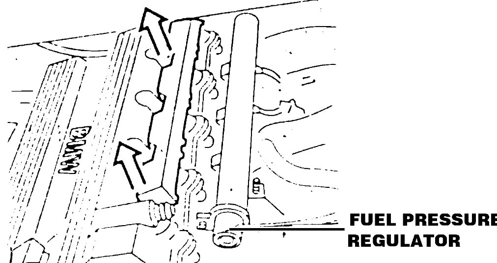

Also, pic 2 below shows the location of the fuel pressure regulator. There will be a vacuum hose attached to it. Inspect the vacuum hose and make sure it is in good condition, not leaking, and is attached at both ends.
Let me know what you find.

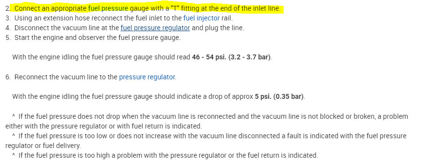

Hi John, it could still be faulty. With the engine running, do you have a vacuum supply to the regulator?

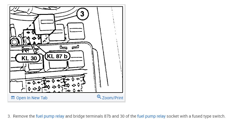

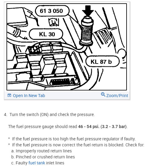

If you look below, I attached the directions for testing fuel pressure specific to this vehicle. Take a look through them and let me know if you have questions.
Because of the model year, there isn't a Schrader valve to connect to. Instead, you will place a T connector in the supply hose and the gauge will connect to that.
