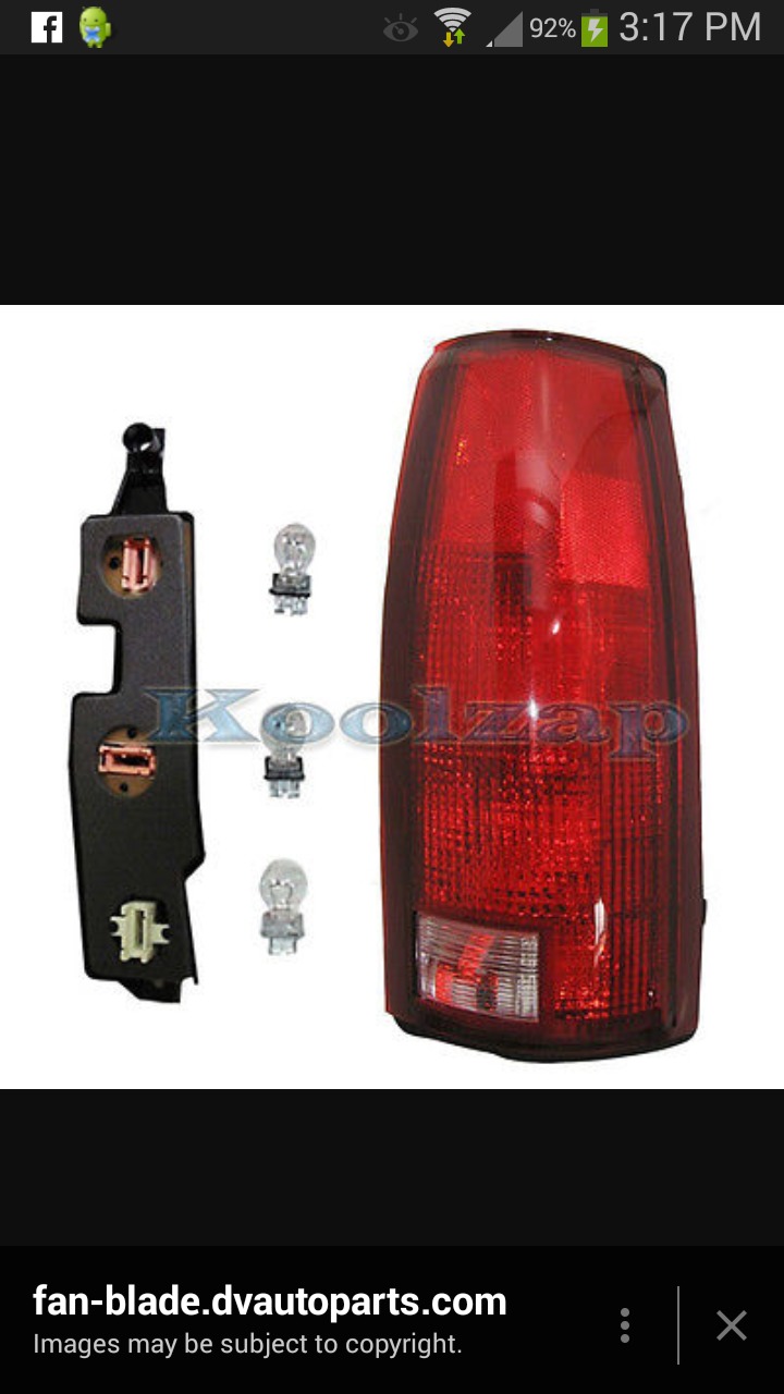

Attached to the back of the tail light. Attached a photo.

My truck has individual ones
