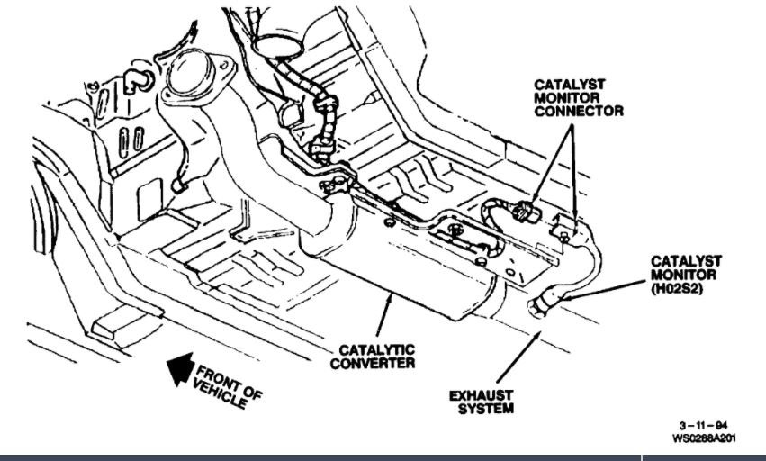

Four months ago I bought it, it ran fine with no issues. then drove to work and on my way home started to run rough and got louder and idles high. acts like if wants to stall or loses power. Changed the spark plugs and ran seafoam through gas and used seafoam spray in the throttle body. No change. any ideas on how to fix?

Good morning,
The running louder could be from an exhaust leak in the system itself.
https://www.2carpros.com/articles/how-exhaust-systems-work
The high idle could be from a vacuum leak causing the engine to run higher.
https://www.2carpros.com/articles/engine-idles-too-high
Is the check engine light on?
