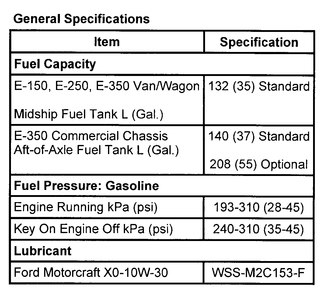

Running rough at high gear 50 mph
1999 FORD E-SERIES VAN
120,000 MILES • 5.4L • V8 • 2WD • AUTOMATIC
SAMANTHA DELIMA
Engine starts cutting out at 50 mph. Cleaned injectors, replaced mas, now running worse. ideas?

If the check engine light is staying on when the engine is running, I would first scan the computer for diagnostic trouble codes. Here is a quick video showing how it is done:
https://youtu.be/YV3TRZwer8k
Next, I would recommend confirming the the fuel pump pressure is within the manufacturer's specs. Here is a link that shows in general how to check it:
I attached the manufacturer's specifications for you.
Start with this and let me know what you find.
