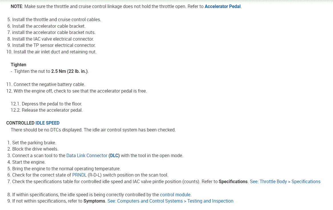

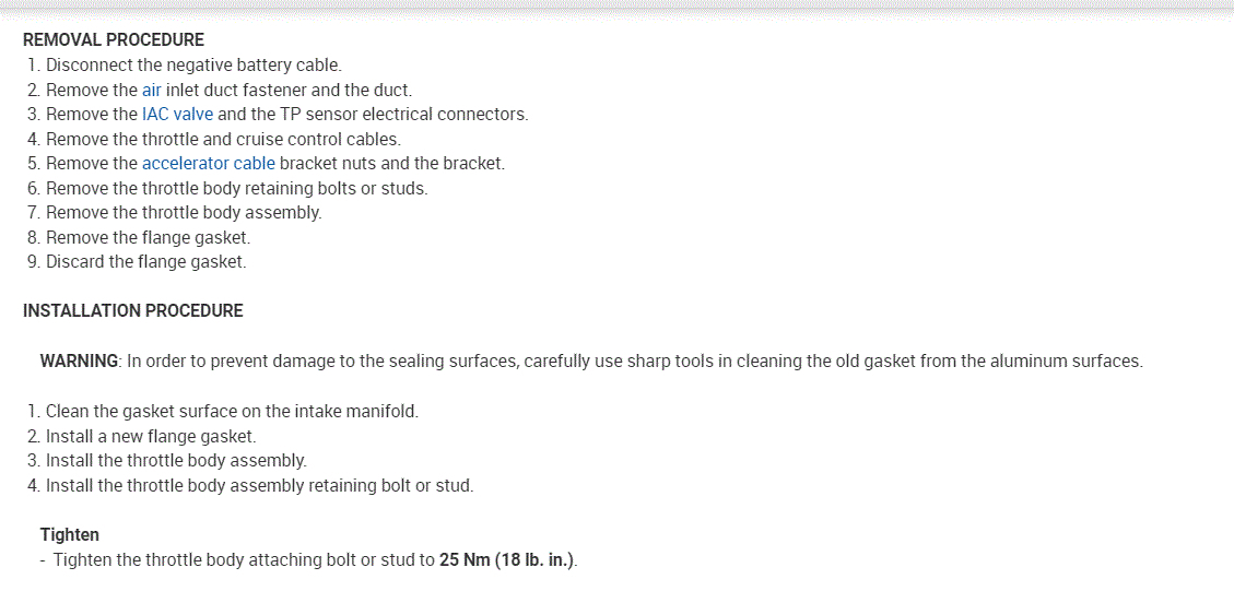

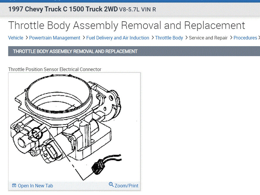

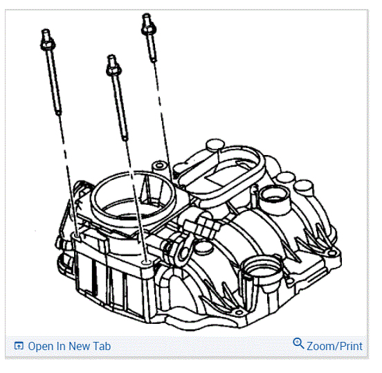

Wow. If a paper towel was drawn into the intake, yes that will cause issues. If that is a possibility, you really should remove the throttle body and see if you can locate it.

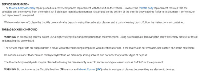

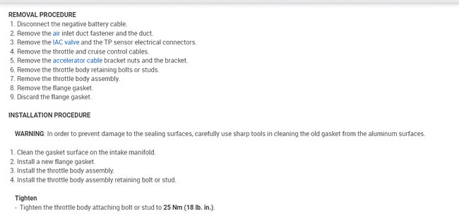

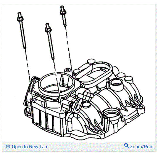

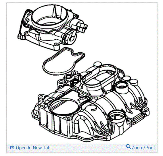

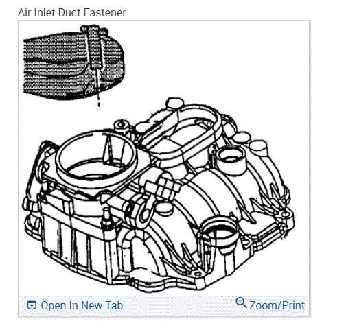

If you look below, I provided the directions for the removal and installation of the throttle body. This is where I would start.
First, do this so we can confirm there is nothing blocking the intake.
