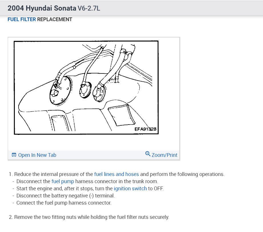

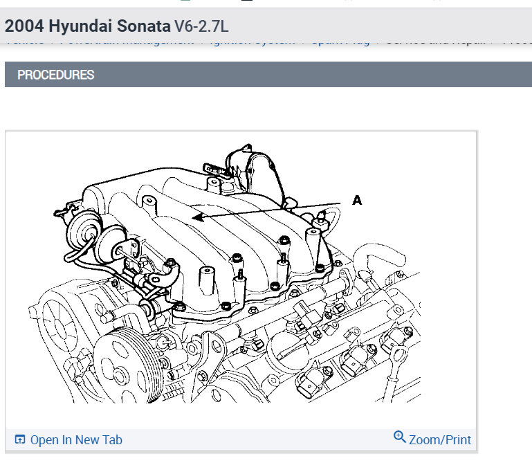

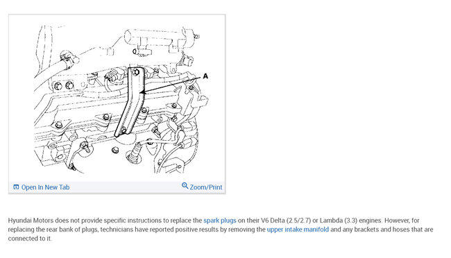

Yes, it could be misfiring, but it should have a code for it, I would do a full tune up if it has not been done in a while and if that does not help, I would suspect the fuel pump is going bad. Here is a generic guide to help you step by step with instructions in the diagrams below to show you how on your car:
https://www.2carpros.com/articles/how-to-tune-up-a-car-engine
NGK .................... PFR5N-11
CHAMPION .................... RC1OYCPB4
Gap .................... 1.0 - 1.1 mm (0.039 - 0.043 in)
Torque .................... 20 - 30 Nm (15 - 21 lb-ft)

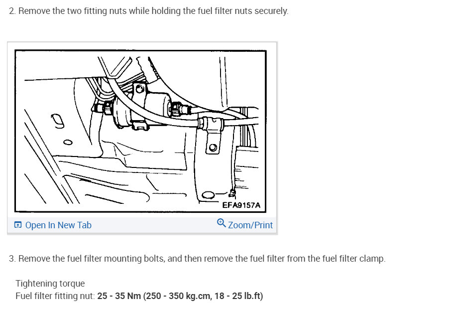

Also change out the fuel filter which can help as well.
https://www.2carpros.com/articles/how-to-change-a-fuel-filter
Check out the images (below). Please let us know how it goes.
