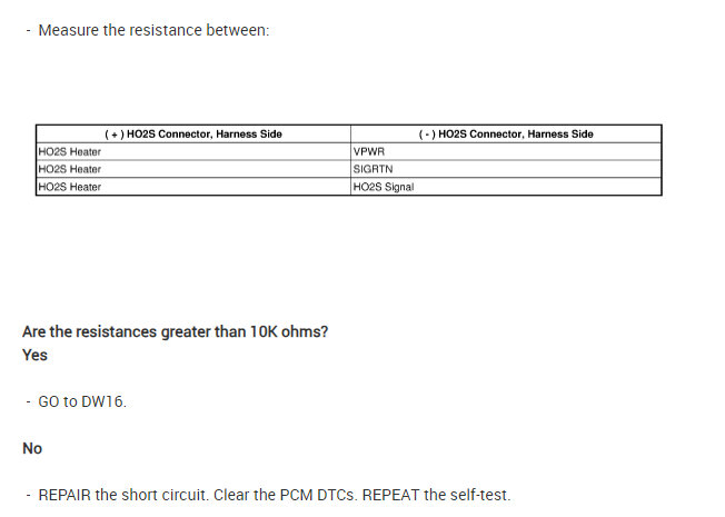

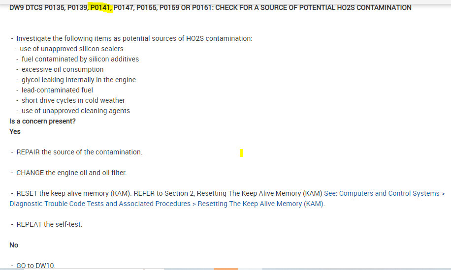

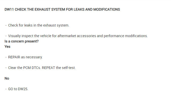

Hello, i need some help trying to figure out what's going on. i attached a video for you all to hear the engine running. i recently changed the ignition coils, spark plugs, fuel injectors, downstream oxygen sensor. I also stripped down both connectors and replaced them with new connectors for the up and down oxygen sensors. Hooked up the scan tool and in getting a P0141 on every starts up. The freeze frame shows the downstream sensor reading at 0 voltage and upstream at 22 voltage.. This is the only code that's on.
May 11, 2024 at 1:09 AM
  • 110,248 POSTS

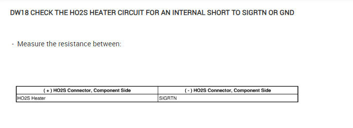

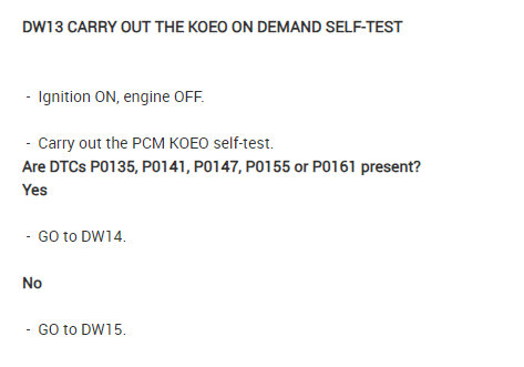

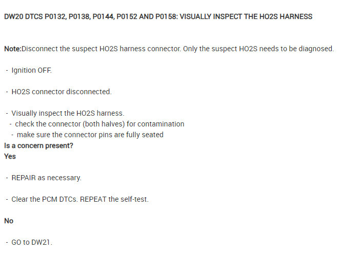

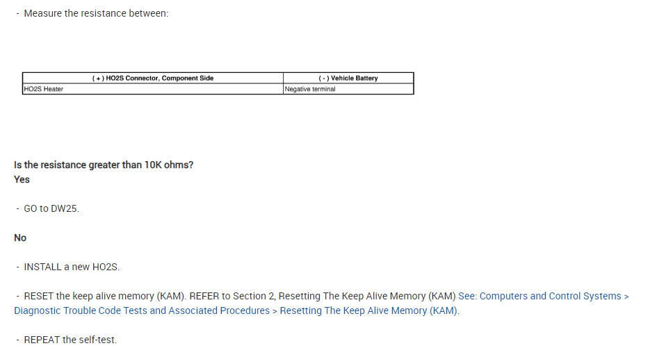

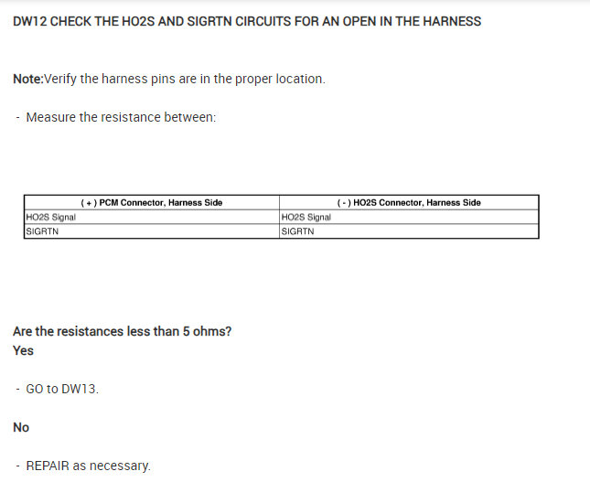

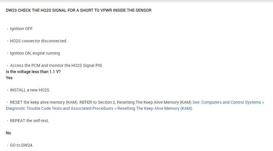

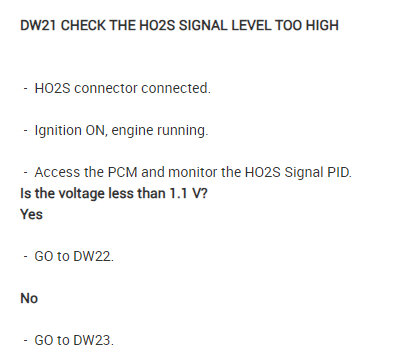

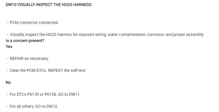

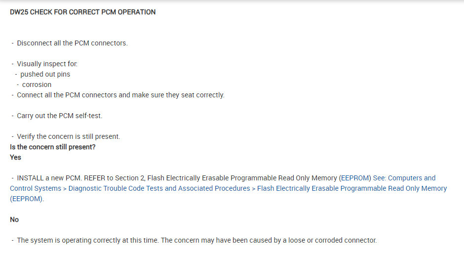

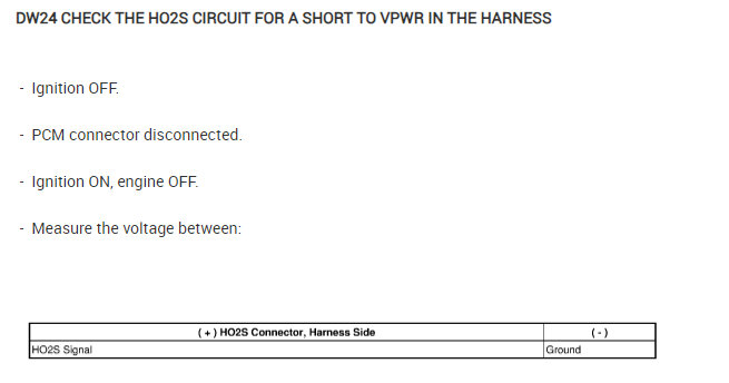

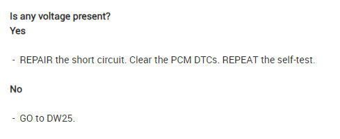

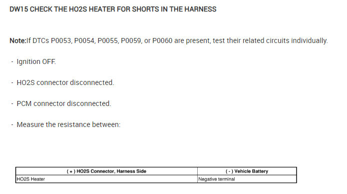

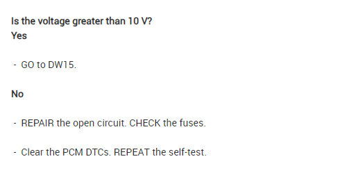

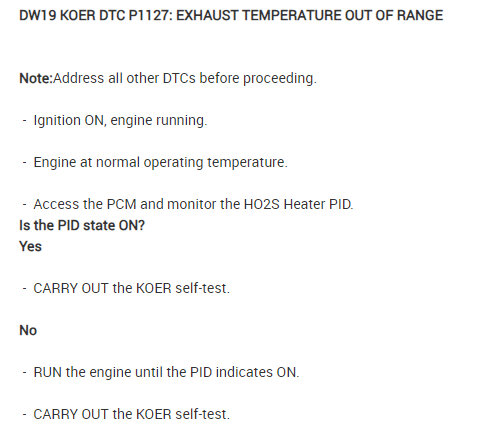

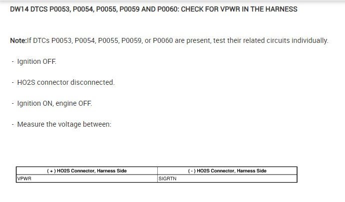

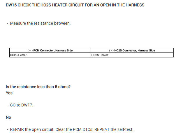

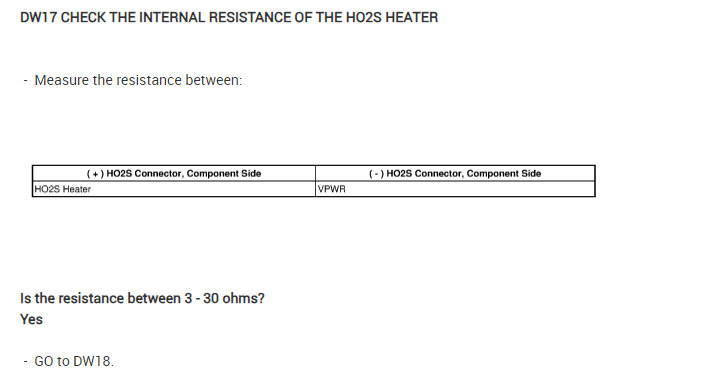

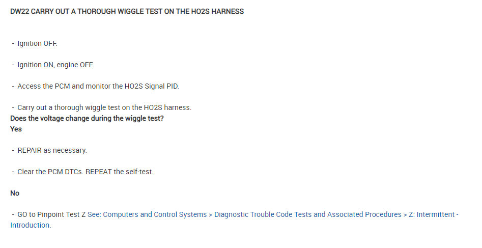

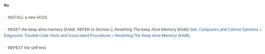

The problem is likely a wiring issue. I attached the diagnostics below. They are somewhat extensive and will require a bidirectional scanner.
Take a look through the diagnostics and let me know if you are comfortable performing them.

Checked all the wiring and the wiring is fine. may have to take it to the dealership for further assistance.
