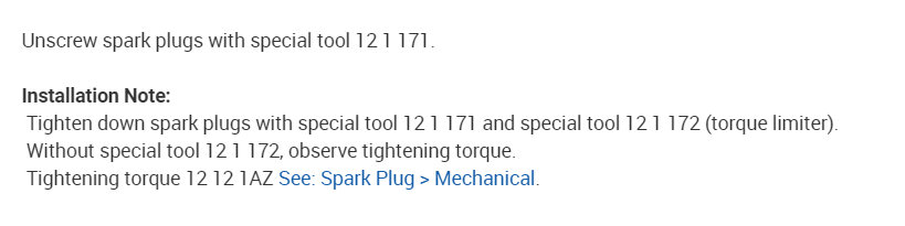

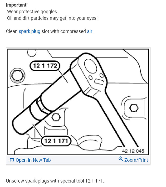

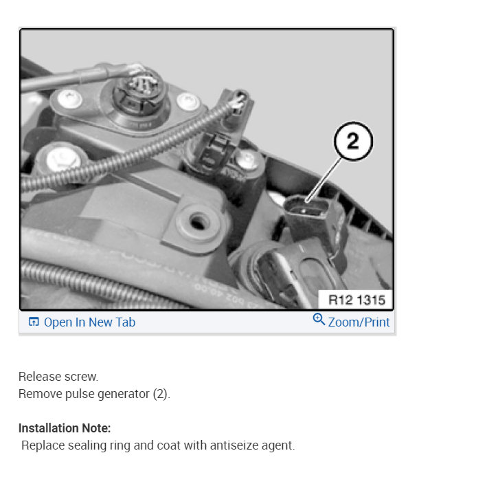

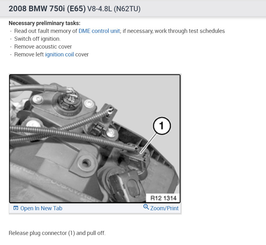

The P0367 code is an incorrect reading from camshaft sensor “B” located in engine bank 1 that is too low, which means the sensor can be out or the actuator is not working. First make sure the engine oil is clean and full, next remove the spark plugs and replace them with new ones, OEM only. The other codes are random and specific misfire codes, which should be cleared once the sensor and plugs are replaced. Sensor B is the exhaust sensor on the passenger side of the engine.
Here is a generic guide to help you with the spark plug replacement and instructions for your car in the images below.
https://www.2carpros.com/articles/how-to-change-spark-plugs
Check out the images (below). Please let us know what you find. We are interested to see what it is.

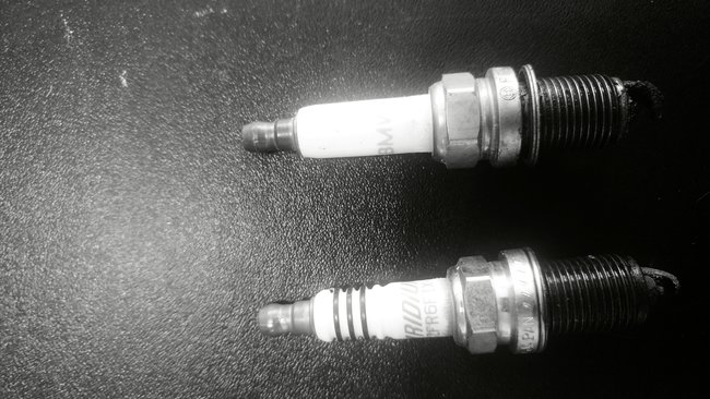

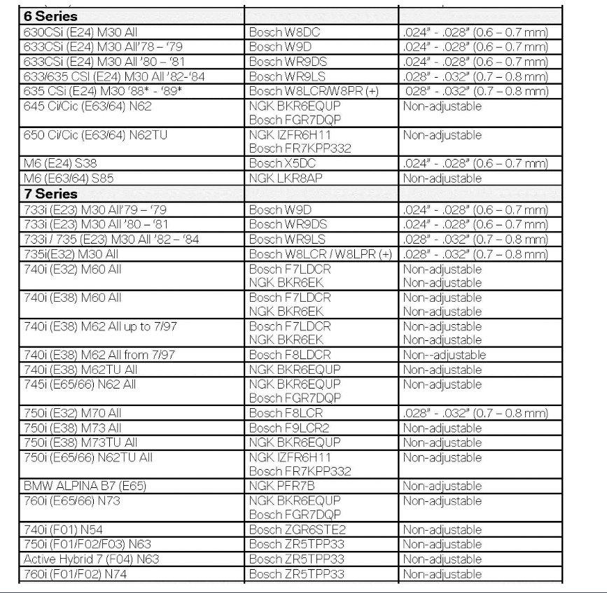

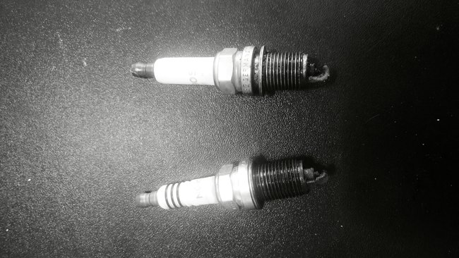

I pulled the plugs and I'm trying to find out what is the OEM plug that I need to get. 7 of the plugs were Bosch and one was NGK. It wouldn't surprise me if these were the original plugs as they were nasty as hell. (Pictures attached). I'd like your confirmation, but I think the OEM is the Bosch ones as they also say BMW on the plug as you'll see in the photos.
Can you tell me exactly what plugs I need to get?
Thank you so much.
Sep 25, 2022 at 12:49 AM
SAM CRENSHAW
  • 52 POSTS
Bosch FR7KPP332???
Sep 25, 2022 at 1:17 AM

It is altogether possible that in the beginning, due to a lack of knowledge, I could have mistakenly replaced the wrong sensors. I believe there are four of them on this vehicle, right?
When I first began this project, I was getting one code, p0391, along with misfires on cylinders 1 and 2. It's never been that good again.
There have also been a couple of times that the battery has drained and I've had to recharge it, as well as being disconnected for a few days at a time, if that could cause a need for me to have to reset something of which I'm unaware.
I'm ready for the next diagnostic step if you can point me in the right direction.
