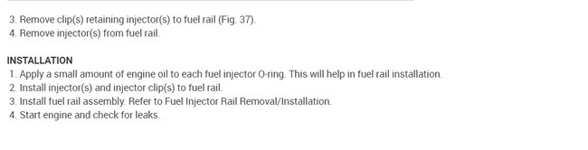

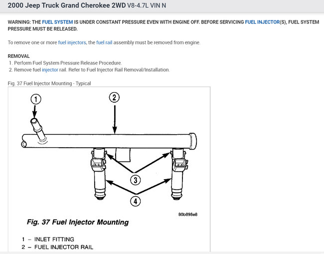

It sounds like you have a bad fuel injector which is leaking raw fuel into the engine, I would remove the fuel injectors and test them which is easy to do.
Here is a guide to help you get started:
https://www.2carpros.com/articles/how-to-test-a-fuel-injector
Here is how you can remove the injectors on your car in the images below.
Aug 19, 2022 at 3:57 AM
