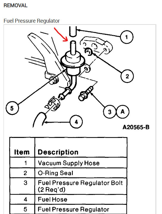

The car is running rich, and it stalls. Today I found that there is fuel in the oil sump I have replaced the Rings. And Alternator doesn't give enough charge.
Jan 29, 2025 at 6:00 PM
  • 55,433 POSTS
Chances are you have a fuel injector that is stuck open, or the fuel pressure regulator is leaking. I would remove the vacuum line from the regulator and see if fuel is present, if so, the part is bad and needs replacement. If that is okay remove the spark plugs to see if any are flat black, this will be the cylinder the injector needs to be replaced at. Please go over this guide as well:
https://www.2carpros.com/articles/why-an-automotive-engine-will-run-rich
Here is the location of the fuel pressure regulator so you can check it out. Check out the images (below). Please upload pictures or videos in your response of any problems so we can see what to help you with.

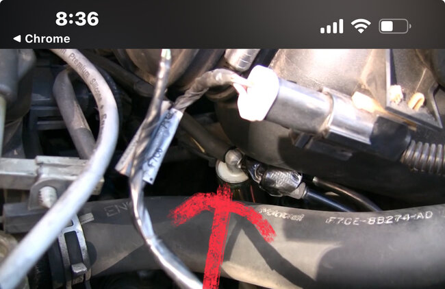

I got the codes
P0122
P0443
P0113
Where is the purge valve does it have a purge valve?
Feb 6, 2025 at 3:18 AM
CARDOCTOR74
  • 62 POSTS
The P0113 code indicates that the PCM sees an issue with the Intake Air Temperature Sensor. Have you checked to make sure your Mass Air Flow Sensor is plugged in correctly and that there are no broken wires at the connector. The P0122 shows as a problem with the throttle body or throttle position sensor. The first thing for these cause I would check is to make sure you have no vacuum leaks. If there are no vacuum leaks, then I would focus on the mass airflow sensor and cleaning the throttlebody and see if these codes do come back. If they do come back, then I would start by testing and replacing the mass airflow sensor and the throttle position sensor. As for the p0443 most of the time, the purge valve does fail. It’s located below the air filter. I would check to make sure there’s no damage to vacuum lines. Wires are connected to the valve. I’ve attached a picture of the location.
