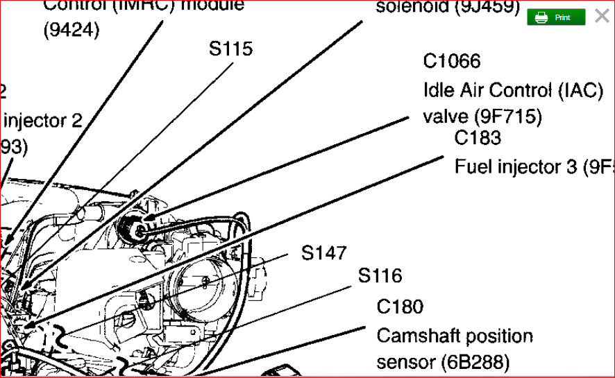

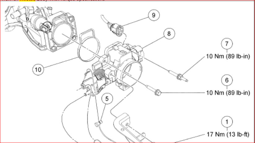

When you first start it it idles high and after a few seconds it drops a little low then to around idling rpm's. It uses more gas than it did most the time and sometimes it does about right and when you go to slow down it feels like it is holding back and when you left off the gas and press the pedal again it sticks. What are some things i can do to fix these problems?
Dec 19, 2018 at 5:18 AM
DANNY L
  • 5,648 POSTS
Hello, I'm Danny,
It sounds like you many be having two different problems related to the throttle body. Number #1 is a gummed up/varnished throttle body blade. I'm attaching two tutorials showing you what is involved. This first one is for your erratic idle. The second is for a throttle body cleaning.
https://www.2carpros.com/articles/how-to-replace-an-idle-speed-control-motor-iac
I'm also attaching two pictures (below) of the location of the idle air control valve and the throttle body. I hope this helps and thanks for using 2CarPros.

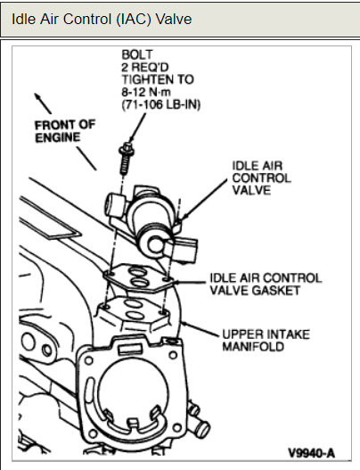

Good afternoon,
The idle air control is common for this issue. It is mounted on top the engine. It has 2 bolts and an electrical connector.
Try starting the engine and then remove the connector and see if the idle drop to a low idle.
https://www.2carpros.com/articles/engine-idles-too-high
The high RPM is why it slams into gear.

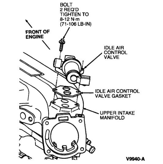

Your issue is likely the Idle Air Control Valve (IACV). It rests on top of the throttle body and is easy to replace - - just has two 8mm bolts, a gasket, and a small wire clip. If you remove the IACV, look inside... if it is black with soot, likely it needs replacement.
Since your check engine light did illuminate, it wouild be wise to get the exact codes. There may be other things hidden. Remember the car computer is not a tell-all, and just because the code says there is a fault, it doesn't mean that replacing the part which the computer says is malfunctioning is the cure.
But in most cases with the IACV, just replacing it is the cure.
Other reason for a high idle is a really bad vacuum leak. Check the PCV grommet connection and brake booster hose. Remove hose from brake booster and plug it with your thumb to test it.
