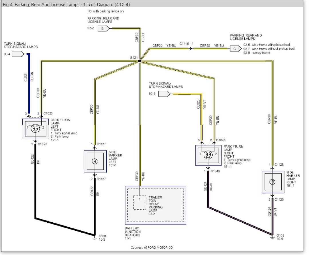

Running lights stay on after i turn off key
2013 FORD F-350
93,000 MILES • 6.2L • V8 • 2WD • AUTOMATIC
ROBERT FORD2
MEMBER
1 POST

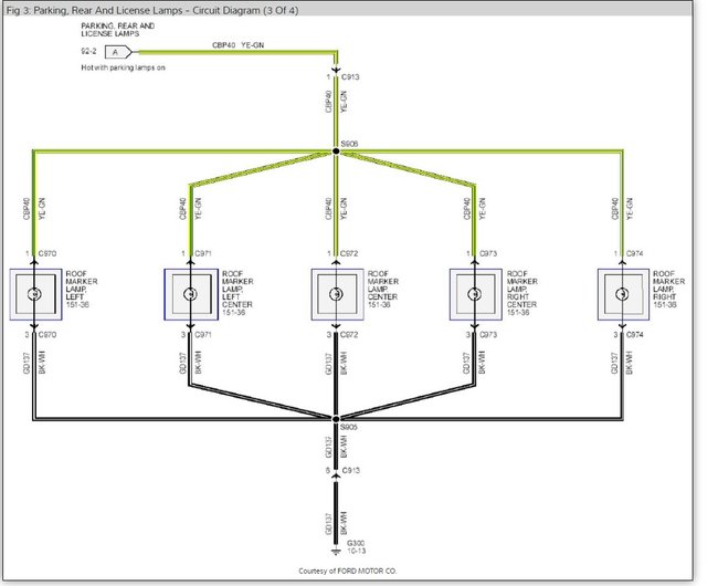

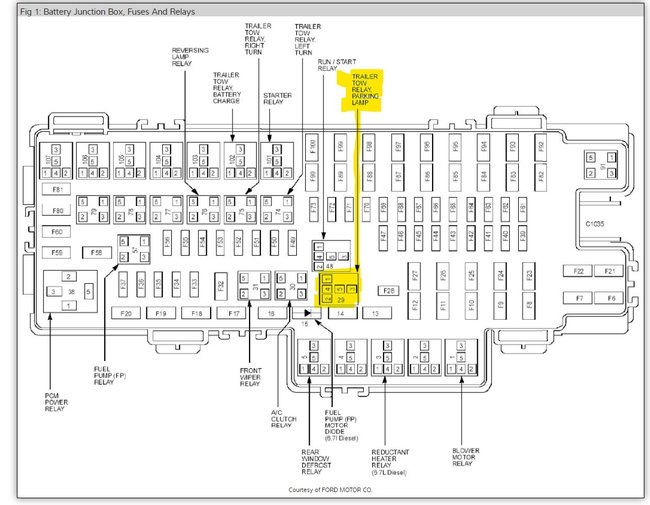

I think it is the relay, but do not no where it is located.
Jan 13, 2019 at 9:28 PM
MPNANTO
Experienced Mechanic
17 POSTS
Hi Robert,
Thanks for visiting 2CarPros. The relay is located in the Battery Junction box.
Diagram below.

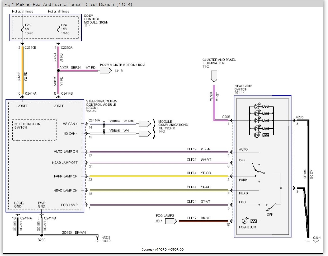

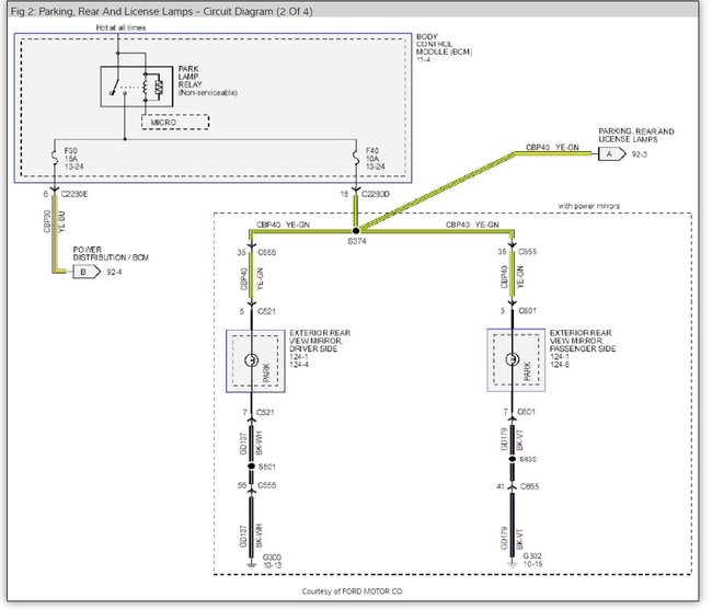

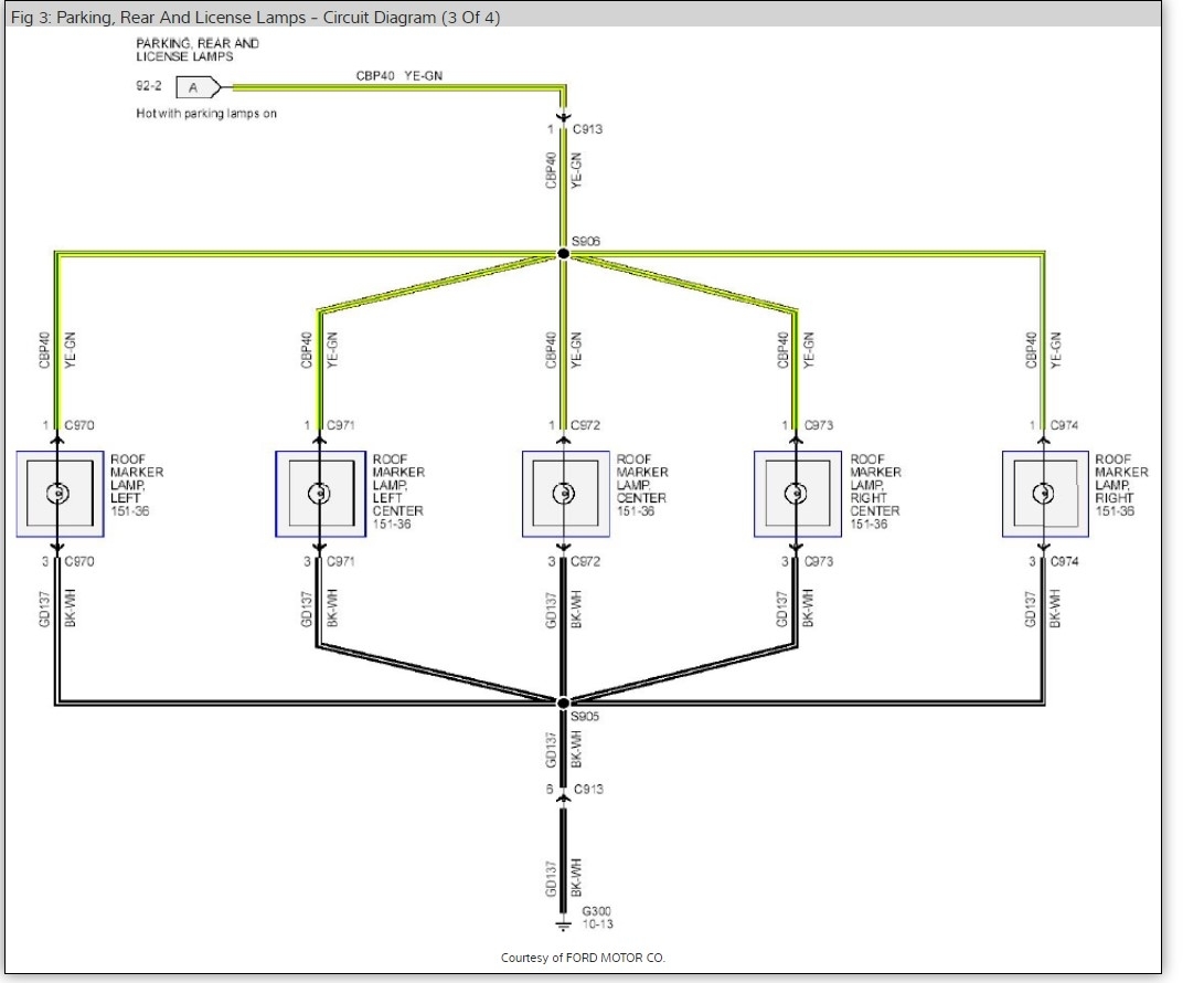

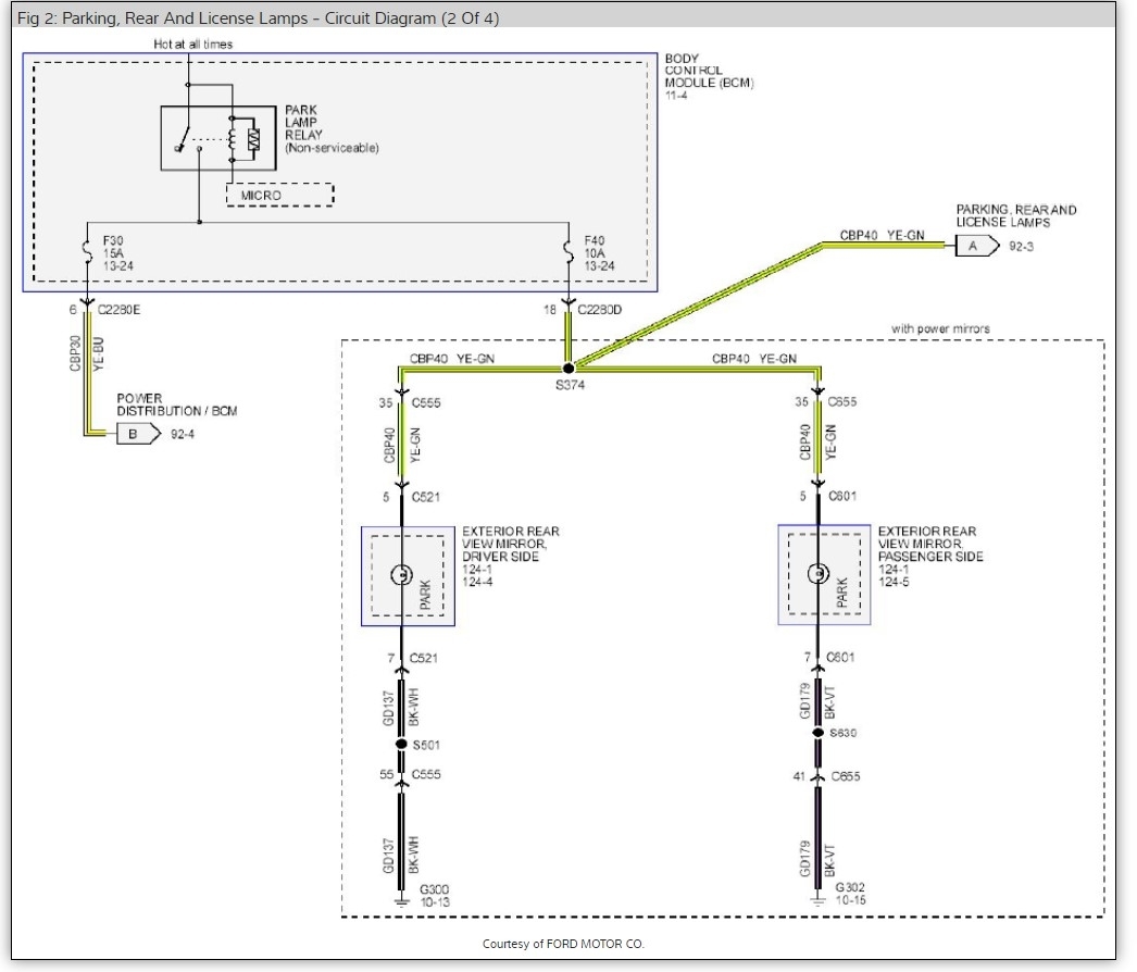

If the relay is functioning properly I have attached the wiring diagram for the running light circuit.
Please let me know if this helps!

Nice work mpnanto :) I also found this guide that will help test the relay to confirm the failure.
