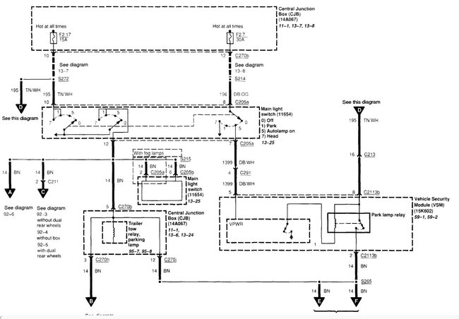

So I had just parked my truck, and I heard the clock of my gauge cluster turn off. Well I turned my lights on, and my headlights work, my brake lights work, and my turn signals work. But I cannot get my running lights or my gauge cluster lights to work. So I went online looking for the fuse box diagram, and I cannot find the fuse for that. I do have an aftermarket radio that I put in about eight months ago now, but this is the first time it has ever done that. I cannot figure out what it is! I am hoping it is something simple like the illumination wire to the radio but I do not know.

Check fuse F2.17 in the central junction block, located left side of dash. Check out the diagrams (Below). Please let us know if you need anything else to get the problem fixed.
