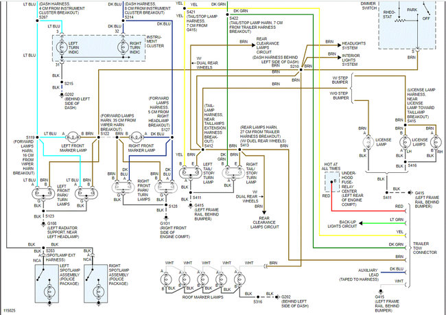

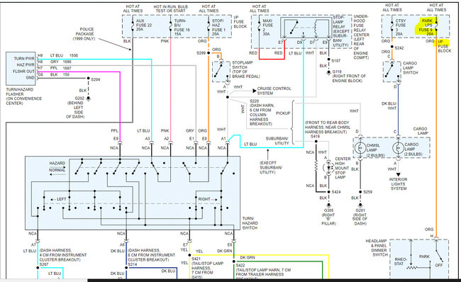

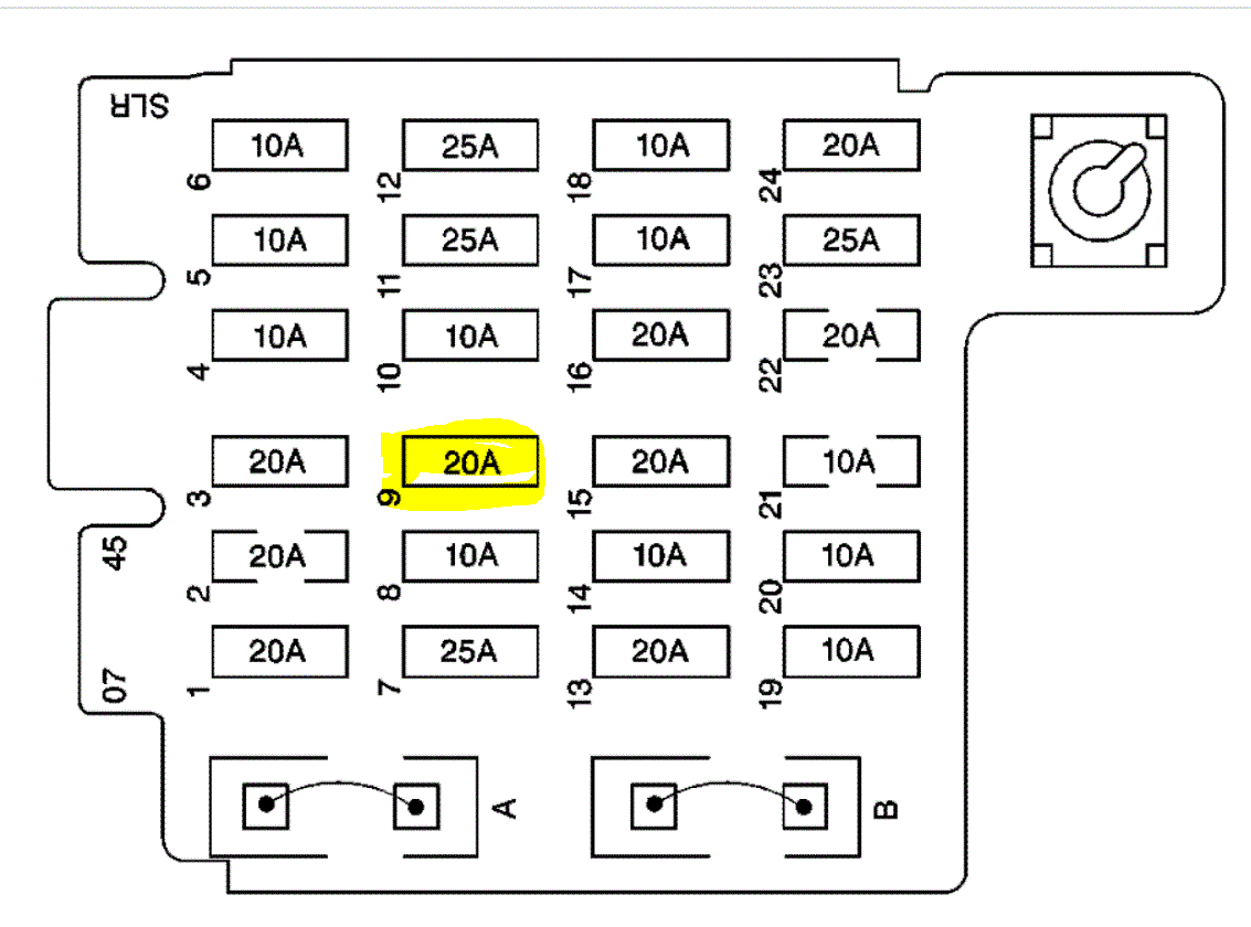

In the vehicle's instrument panel fuse box, there is a fuse for the parking lights which also runs to the instrument panel.
Below, I attached three pics. The first two contain the wiring schematic for the entire exterior lighting system. I highlighted the fuse I'm referring to. In pic 3, I attached a pic of the fuse panel in the vehicle and highlighted the fuse to check.
In addition to checking the fuse, confirm there is power to and from it as well. Here is a link you may find helpful when doing this:
