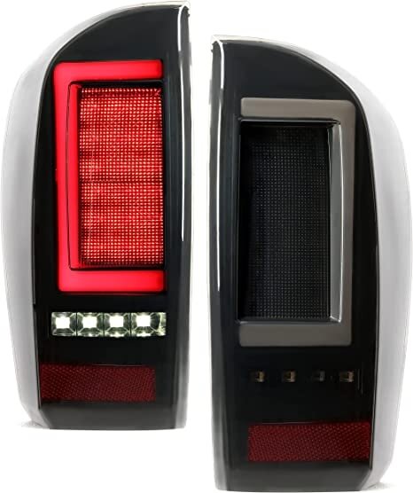

I had to change my taillights due to an accident where they were busted out. I upgraded to new LED lights to have better visibility after dark when in reverse.
I initially bought the set online via Amazon through a company down south, after I installed the first set, I noticed they wasn't working right, contacted the company and they sent another set free. This happened two more times also. I've had two people look at the lights now and no solution.
The rear brake and turn signal lights work perfectly but there is no current going to the "running lights" other than the third brake light which I keep on just for other drivers' visibility of me. Talked to a repair tech and was told to just upgrade the fuses, did that. All new fuses have been installed. What should have been a simple install has become a nightmare so far and I'm out of options without taking it directly to a dealership, which would cost hundreds just to diagnose and then probably triple to fix. I appreciate any and all help.

Below are the lights that I bought for $125/set Kojem LED Taillight Compatible with 2016-2022 Toyota Tacoma Brake Lamp Black Housing Smoke Lens Pair.
https://www.amazon.com/dp/B09MH4LKQF?psc=1&ref=ppx_yo2ov_dt_b_product_details

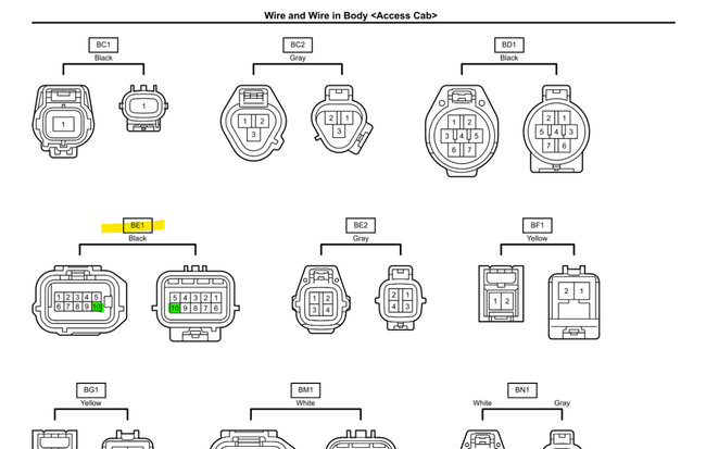

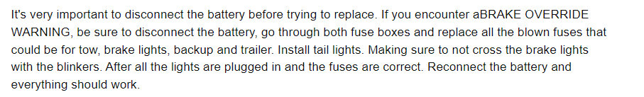

Okay, I'm not worried about the accident part, we're here to get it fixed, that's all. When you say he changed the polarity, did he do this with the LED lights? Possibly switch power to the ground side of the LEDs? Because LEDs are diodes, (light emitting diodes), and a diode will only allow current to flow in one direction. So, reversing the polarity would do nothing, especially since your taillights were working before the changeover. I was reading through the info from the link you posted, I would go through and recheck all the fuses. There was a warning about disconnecting the battery before trying to install this set for whatever reason.

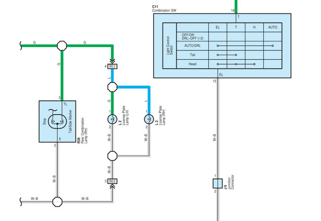

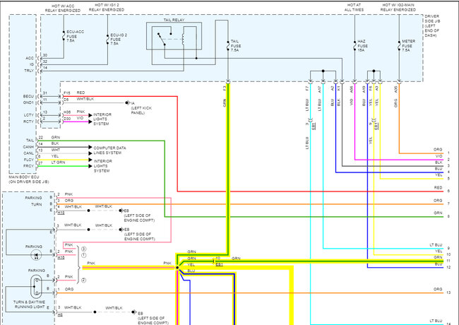

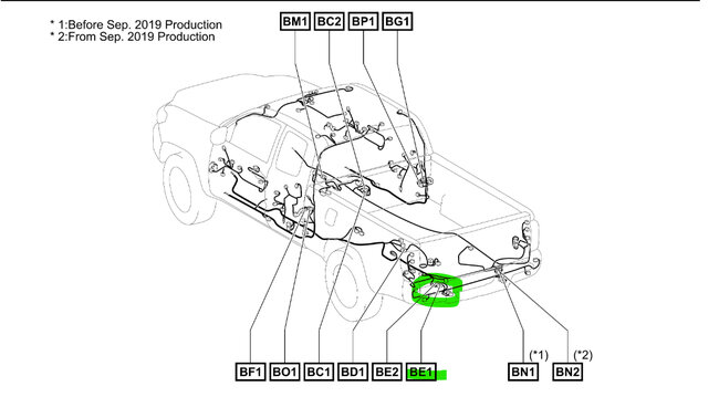

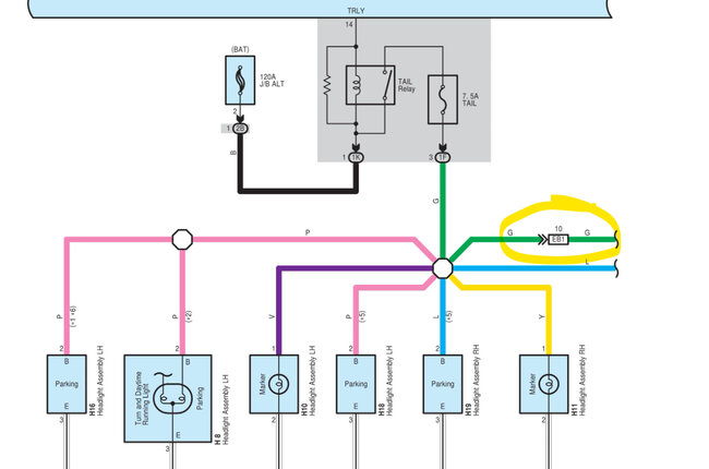

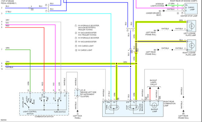

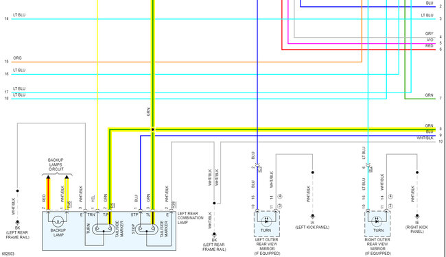

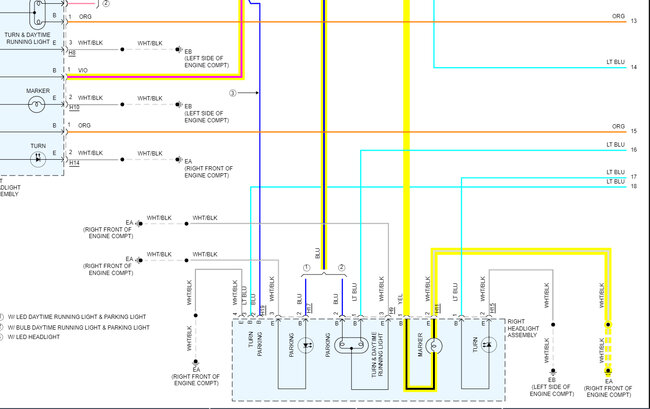

Below I'm posting the OEM diagrams and I only see one connector between the front marker lights and the rear taillights, and I think they even may have it labelled wrong. In the 1st diagram, the connector labelled EB1, there's no eb1 connector, so it has to be BE1 which is in the second diagram, pin 10 of that connector (third diagram, green wire) is the feed to diagrams 4 and 5 (green wire) which is your tail and license plate lamps.
Since the power for everything, front markers, parking lights and all the rear marker lights goes through the Tail Relay to that 7.5amp Tail fuse and then branches off and the only connector is that Eb (Be1), I would go to that connector and see if there is power there on pin 10. If not, you'll have to start going through all your fuses thoroughly.
I can't see how the fronts are working unless that connector got messed with or is not making a good pin contact inside. It can't be a bad ground since your Brake lights are working.

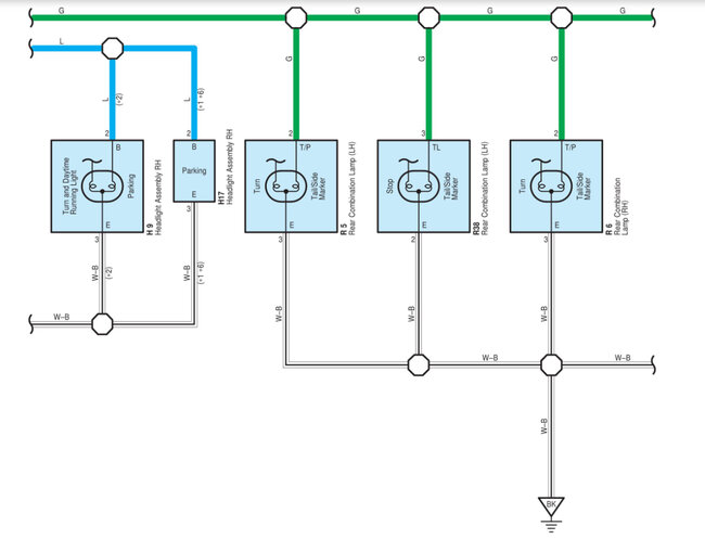

I'm also posting the aftermarket diagrams so you can see the entire circuit. But let us know what you find.
I added the warning I found
