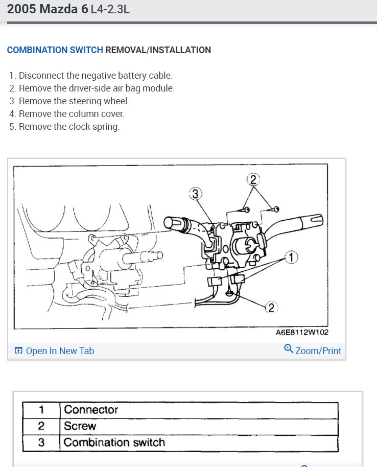

Running lights work intermittently. There are times when I cannot get them to work.

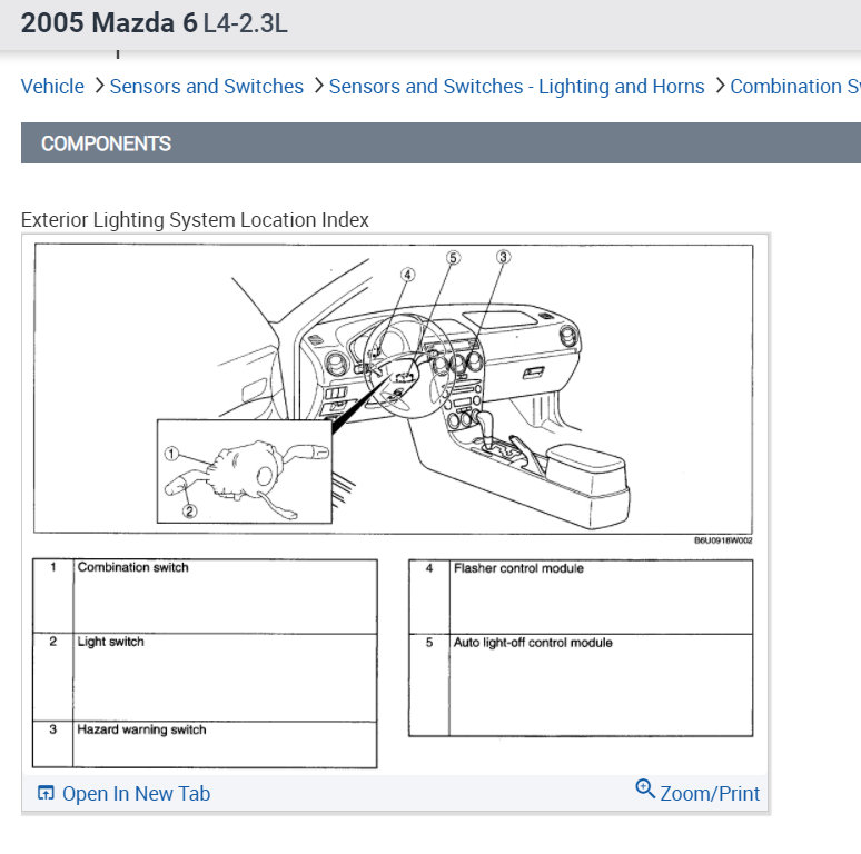

Chances are the switch is the problem, here are instructions on how to remove the switch so you can replace it with a new unit. Check out the diagrams below to see how to do the job yourself. Check out the diagrams (below). Let us know what happens and please upload pictures or videos of the problem.
